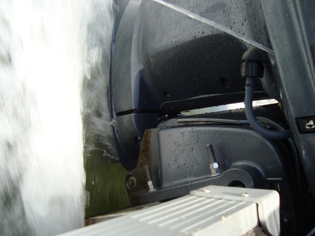

Hey BMR. What exactly is Cavitation? I have a problem when I try to trim my engion up. Its like there too much air and not enough water.. I lose speed when I start to trim up past the half way mark. I was thingking of tring a hydrofoil. I have pics of it in action, but not sure how to post them :donno

Durante wrote:
badmoonrising wrote:If you mean hydrofoil, I have one and it cured a problem with cavitation I had periodically with the PC.
I think I figured out how to put a pic up
[img]
[/img]
Motoring along, you'll have an increase in RPM with no forward motion. You'll hear the prop spinning...throttle back and accelerating usually make the prop get a grip. Adding a Doel Fin prevented it from happening on the PC in rough water.

#9 Post by badmoonrising » Mon May 24, 2010 5:39 pm
Durante wrote:
[img]
[/img]
Don't see a hydrofoil in your pic, the skeg is under water :rofl

Durante wrote: I have a problem when I try to trim my engion up. Its like there too much air and not enough water.. I lose speed when I start to trim up past the half way mark.
[/quote]
Um, I may be wrong, but I don't think any engine would be able to trim half way up without cavitating. That is way up. When I trim mine out for speed, I actually only come up about 10deg.
