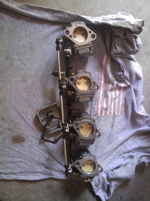

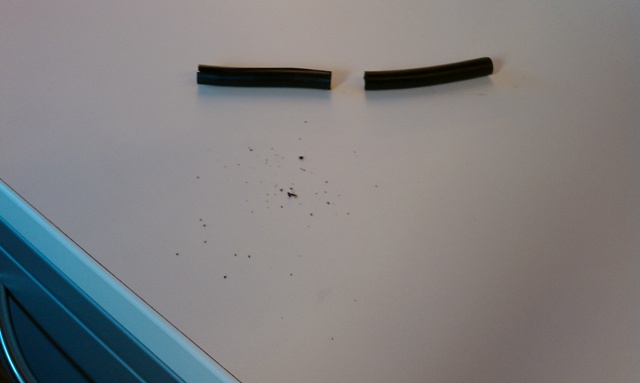

So the first carb went fine tube was almost clogged. My bro ask if I gonna change the fuel lines.
Wasn't planning on it the look great on the outside!
Well lets just look at one he says. :smoke
Son of a bitch!! :bowdown :bowdown :bowdown :censored :censored :censored
We blew it out with brake clean and all kinds of black shit blew out. Even after that looking through it looked like a 16 year olds face :rofl
I cut the tube and lightly brushed it with my thumb this is what came off. Keep in mind this is after we blew it out.
Three more carbs and 4 hoses to go.

Good detective work! Good thing you took the time to do it. If you had kept on running it with a partially blocked carb, it would have been way too lean and thats how you blow a top end!

Definitely time for new lines. Make sure you really flush out the needle and seat area to get any of that fuel line crap out of there...if not you'll be fighting flooding out carbs for sure. Looking good. 8)
