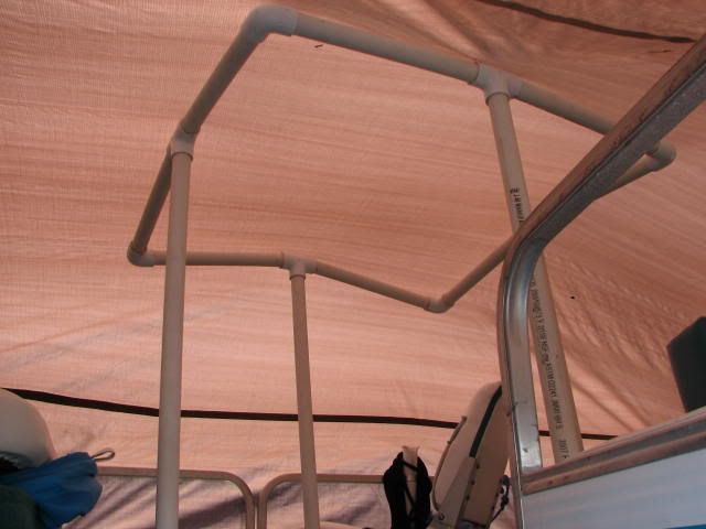

this is what I had
use now

Yes it is quickcrete. I drilled a hole in PVC in bottom of coffee can and ran a piece of re bar through to keep from slipping out of concrete. I used 3/4" pvc in can I then put a 1" inside 3/4. While under cover Betty raised it up till tight and marked it then I drilled a hole for a bolt. On top I used a 1/2 cap with a 2"cap screwed to it using a recessed screw hole.
The only place we had water pool was over tanning pad. That's why I made the modified A frame. Hint-- ink from pvc pipe will permanently stain vinyl so cover it or be sure and remove writing on pipe.

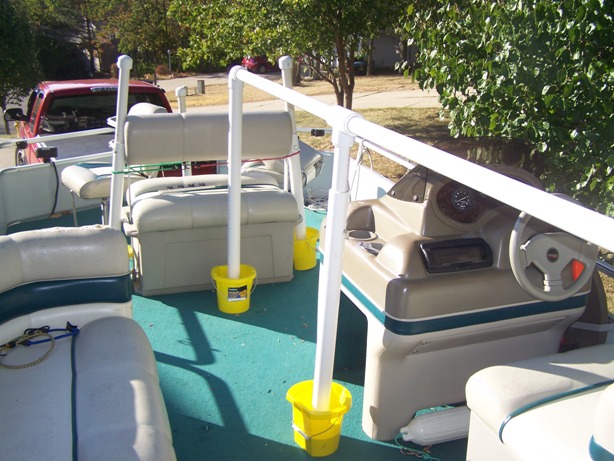

#9 Post by jeffybear » Mon Sep 27, 2010 3:36 pm
jeffybear wrote:I like it Lakerunner, this is exactly what I did, but I don't have a fitted cover. I'll get some pics and post soon. If the toon is sitting on level ground I've never had standing water. Fairly cheap too. I used 1.5 pvc.
took me a while but I've got pics as promised.
View of the cover. It's always nice and tight. Never had to push water off of it.
view of bucket
view of the extender

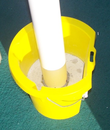

Here is view of the support foot. I purchased buckets from lowes, then filled them with quickcrete. I inserted a 2" pvc section into the quickcrete and then once it hardened I can insert the longer pvc tube, I then drilled through that and placed and extender and drop a 1.5" pvc down through that. This way I figured I could make the support whatever height I needed. One thing I wish I had done that Lakerunner did and that is to place a stick or rebar or something complete through the bucket, occasionally my quickcrete section will slide out of my bucket when I am removing it from the toon.

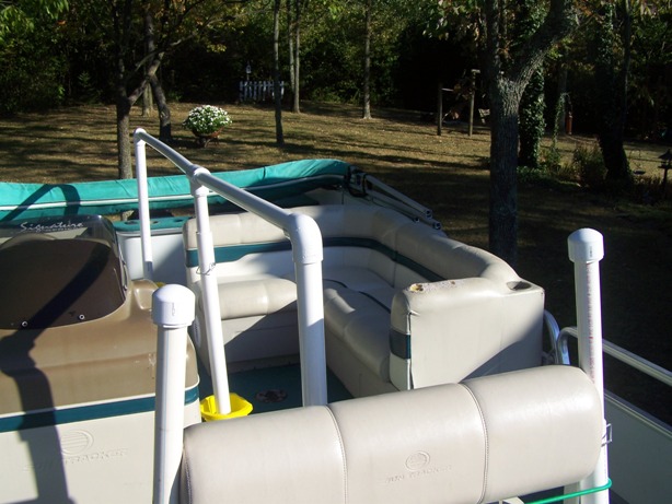

View from aft to bow. I did not glue any of the joints, glad I didn't, I think I'm gonna extend the 3 sections to 4 and get rid of the two that are on either side of the seat near the bow.
This shows pvc supports. I have one smaller one in the front (not visible), followed by two on both sides of the deck lounge/livewell, then 3 connected to each other to the aft of the toon.
