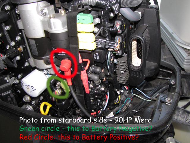

Re: Mercury 90 h.p 4 stroke starting problem
Ghost Rider was right - I maybe over-complicated this one. I now think that I haven't been putting the cable to the battery to the proper terminals.
Before I go and ruin something - any comments from the experts here on my analysis?
Thanks in advance.
Thanks in advance.
In your last picture, the green circled area has a Pos cable end AND a neg cable end laying up against a bulkhead. Have you been hooking that one up? Easy to miss................
@parasympathetic - yep, I now am sure I have the battery connected properly. Accessories that are available without "RUN" work (nave lights, horn, stereo, lights for gages).
Neither trim switch works in either UP or DOWN positions, and nothing happens in the START position. The only common thing I can see is the 30A fuse in that circuit. Gotta double/triple check that today.
I'll also check my wiring diagrams to see if the ECM circuit is common. Not sure where that's physically located.
Guess I'm closer....
