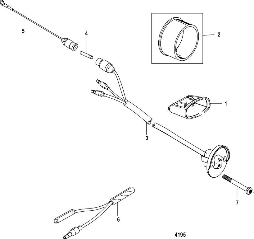

I've used the search to try to find an answer to this I can't find one so I'm gonna have to ask. I have a 2000 Mercury with a 50 hp 2 stroke outboard. This was weekend #3 on the lake... the tilt and trim has been working fine until this weekend. The t/t switch does not seem to be working. Upon first inspection it appeared to be pushed too far in, released that hoping that would take care of the problem but it did not. It wants to stick in which ever direction you push it. The switch is on the throttle handle. Can I just replace the switch, or just the throttle handle and switch? Thank you in advance for your help.

On the models I have worked on the power for the Trim comes from the fuse block and that switch being bad or not having a solid connection could also cause issues using the trim buttons on the motor. These were older models so I am not 100% sure that it is true for yours. There should be 3 wires, one is the power and the other 2 are up and down... Check the fuse first... If that is good try jumping the power and one of the 2 other wires to see if it is the actual switch.
It could be the Switch, Fuse, Relay or simply an loose connections.
