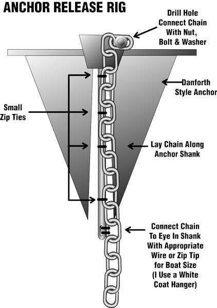

We use our fluke that is rigged with chain "backwards" with a couple zip ties, so it it gets hooked on timber , i can break zip ties and it flips up and frees itself...so far so good.
My issue is with coves that are 100ft x 100ft and 80 ft deep, i cant let enough chain,rope out to set it, so we tie off to trees and let wind hold us in middle of cove
Here is anchor mod
Here is anchor mod

I really like that idea, Bansil!
Our boat came with a fluke and a mushroom, but we really don't anchor. Our lake is very sandy and heavily wooded, so we sometimes beach and tie off, but generally head back to the boathouse for breaks - and refills - and more ice - and more. BUT, I am going to rig my fluke that way this weekend because we live on a "young" lake with submerged logs/stumps.
I thank you for the great tip.
