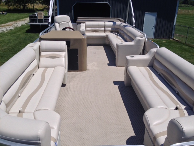

- 1.JPG (164.13 KiB) Viewed 6821 times

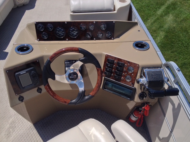

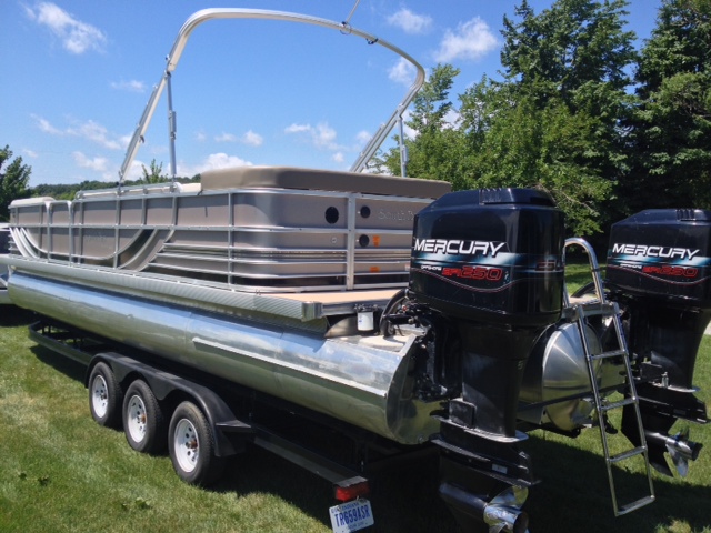

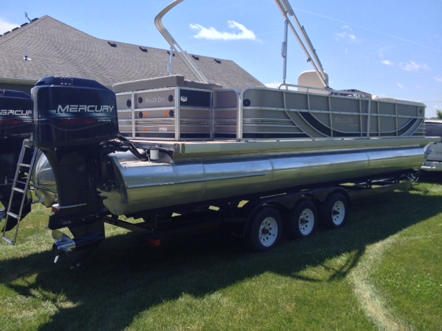

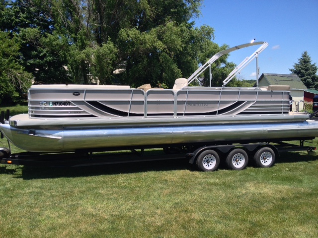

Some more...
- 3.JPG (146.66 KiB) Viewed 6817 times
- 5.JPG (124.58 KiB) Viewed 6816 times
- 7.JPG (112.69 KiB) Viewed 6816 times
- 11.JPG (124.11 KiB) Viewed 6817 times

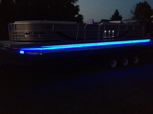

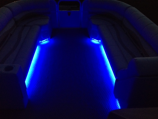

And some night shots...
- 28.JPG (82.78 KiB) Viewed 6811 times
- 29.JPG (92.97 KiB) Viewed 6811 times
- 30.JPG (83.65 KiB) Viewed 6809 times
- 32.JPG (78.67 KiB) Viewed 6809 times
