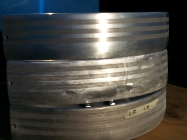

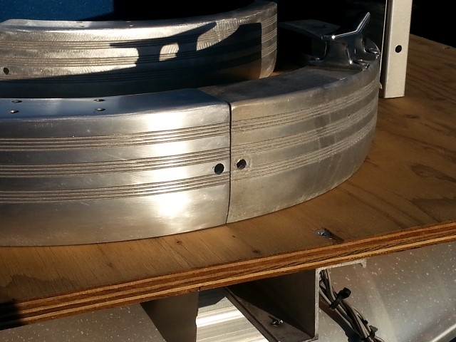

Happy Hump Day. Spent time working on the cast aluminum corner caps. I initially did an acid wash but that may have been a mistake. Got lots of little pits. So I attacked them with my new toy Porter Cole dual action sander/polisher. WOW, it sure makes things much easier (a relative term) then hand sanding. I ran through 60/120/220/320/400 grits and hand finished with 800. Now don't know if I should keep with the sand paper or switch over to compound. Any suggestions? I am also faced with trying to get the cleat screws out on two of the corner caps. I have tried the usual WD 40, penetrating oil, and even used a wire wheel to clean up the treads on the back side but I can't budge them. The others came out with a hammer screw driver tool but the six remaining fought back real hard. I am thinking about gently heating the aluminum in the area of the screws to see if that will loosen them up. But I don't know if that will hurt or discolor the metal. I have done lots of copper sweating in the past but want these to stay pretty. Below are a couple of pictures.

Lookin good. Are the nuts on those bolts Nylock nuts (with nylon inserts)? If so nothing will help. They were probably put on incorrectly and the threads are galled. Cut / drill them out of there and replace them.

There are no nuts. The aluminum is threaded and the bolts are just screwed in. Will try a mild touch with the torch and see what happens.

You're kidding?!? I've never seen any thing like that. The generally accepted method is to go through the cap AND the plywood, or just the plywood and either way use large SS washers underneath. I'm not sure how your corner caps were mounted but most wouldn't keep a boat moored in rough conditions. Might want to double check the method...

The pontoons were in generally good shape except for the thick scale at the waterline and discoloration below that. An acid wash cleaned up most of the discoloration but did not touch the scale. I am having to go with very fine sand paper to remove the scale as the acid and various scale/lime removing products did nothing. Toonguy the cleats went through threaded holes in the corner caps with bolts as I stated before. I recall that they did extend into the deck but there were no nuts involved. I will correct that on the reattachment. Several of these bolts refuse to come out. I used vice grips on the exposed bolt ends and finally got them to turn. I then cut off the marred end of the bolt and was able to remove. The final two are up against the side of the cap. I was going to take pictures but it started to rain and I had to get things put away and covered. Will do it tomorrow. Thanks for your comment Discovery. I have been generally impressed with the quality of the Premier but that surprised me also.

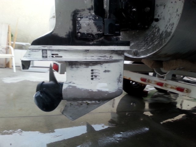

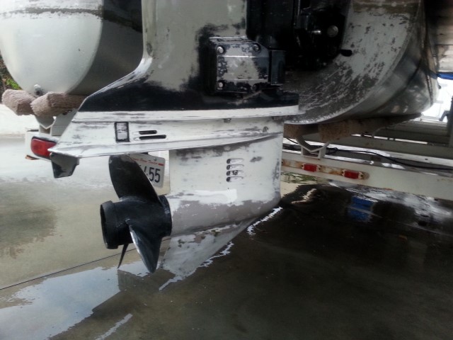

No major changes to show but a lot of sanding and cleaning on the outboard. It looks like the lower end has been replaced with on a couple of years older (color difference and also water inlets design) but it all checked out on the overhaul. I have found that using vinegar in a spray bottle with soften some of the scale on the motor and mount but does not seem to do much to it on the pontoons. I did take a better photo of the anti cavitation plate area and the center pontoon so you could get a better idea of how deep the motor sits when trimmed all the way down but the browse button not letting me browse at the moment so I post then later. Happy Turkey Day to you all.

#28 Post by captainjohn » Thu Nov 27, 2014 3:37 pm

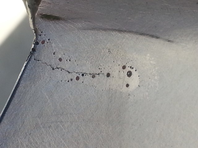

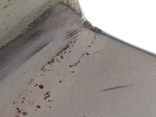

Spent today finishing the sanding of the lower unit of the outboard. There is some pitting and also a small crack at the base of the skag at the rear. I don't know if I need to be concerned about these two things or not. There was also some pitting on the prop edges. Any ideas out there? No salt water use. the lower unit was apparently replaced at some point so I am not sure it these occurred with this boat or not.
