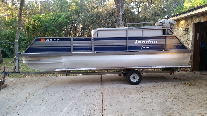

1992 Landau 18' Resto

Thanks Dave, This is a case where the pictures really DO it justice..
The fence paneling is pretty dented, replacing it was definitely not in the budget, so close up it shows. Looks 100% better than it did though.. Especially for a 25 year old..

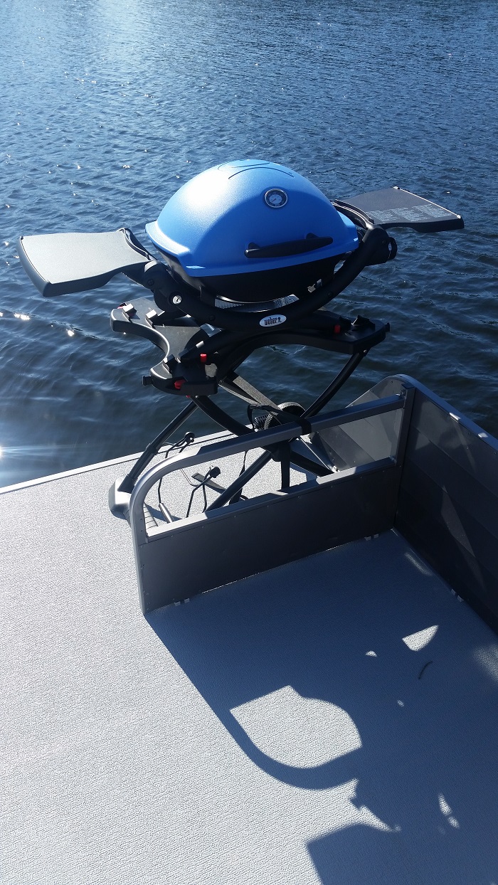

A couple more..
First on toon BBQ over the weekend, Hot dogs!!
- 20170409_165546.jpg (279.72 KiB) Viewed 13081 times
Re: 1992 Landau 18' Resto
Highly recommend the little Weber Q1200!!

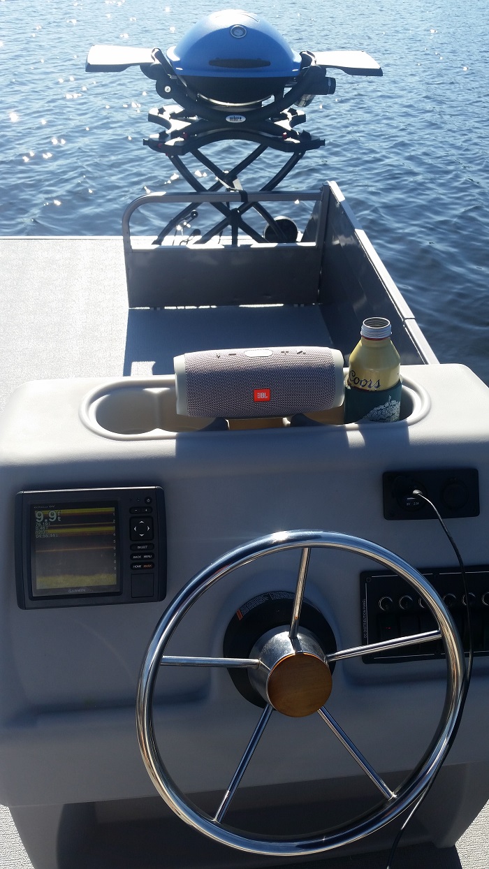

Very nice job, Sir; it looks well thought out!
I noticed your stainless wheel. That's the first thing I've changed out on all my pontoon boats, as the extra leverage from the larger diameter wheel helps offset the stiffness of those "zero feedback" clutches they put in the steering these days.

Thanks Rick,
I agree. I now need a suicide spinner knob on the wheel!
I replaced the complete steering assembly with a Seastar safe-t QC rotary system that I would recommend.
Also had a problem with the control box being stiff, hard to shift. Took apart the Yamaha 703 and cleaned/greased it up, but still stiff when connected to the motor. Found that if I disconnected the cables from the motor the control box worked smoothly.
Also when the cables were disconnected from the motor, the motor throttle/shifter worked fine by hand as well. But when all was connected up, stiff as hell.
Ended up being the cables themselves. Replaced with a set of Seastar Xtreme 3300 cables and now smooth as butter..
Can recommend a set of those as well..
