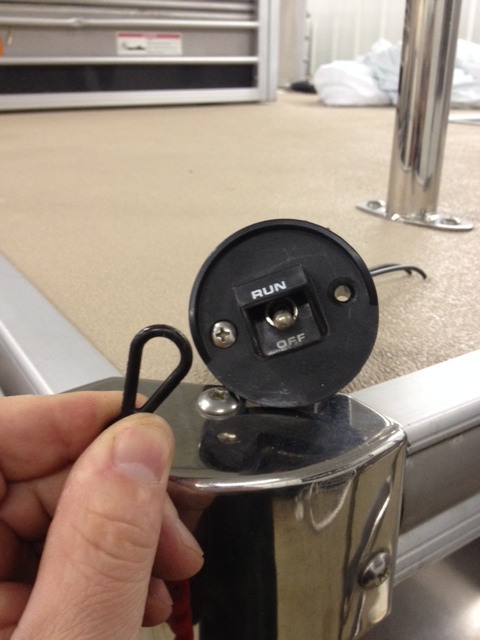

That is the same lanyard kill switch as the one on our Premier, the lanyard has a ring on the end that slides over the toggle switch, then you flip it to the run position, it will stay put until you pull on the lanyard, then it flips the switch to off and the lanyard slips off the switch.

I have the same as above on my Jon boat

Well there you go. Ya learn something new every day. I was incorrect about the key switch haveing the "click-in" lanyard, that was on my Suzuki I received near the same time. Looks like I have what you all have:

I'll have to look at mine now and see if there is a way to attach a clip. I would think that would pull right off and not necessarily down..... :donno

Nope...right now the switch is in the OFF position. If you put the ring on it and flip it up, that plastic "top" traps the ring in there. No way it can come out with out shutting down both motors. This switch plugs in to my binnicle control.

I see it now. Mine may actually have that "trap" as well... interesting. :?

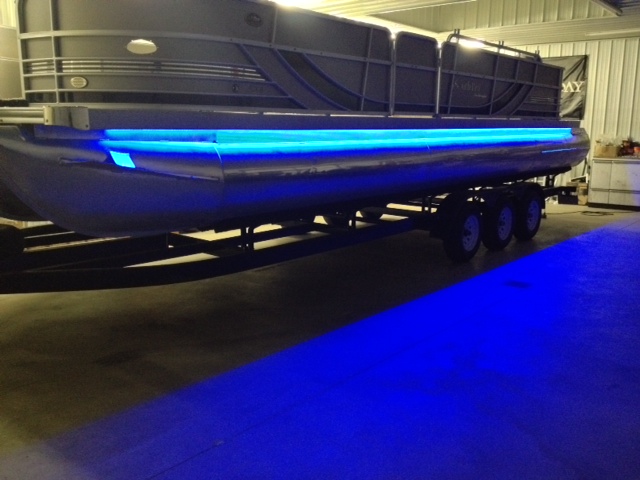

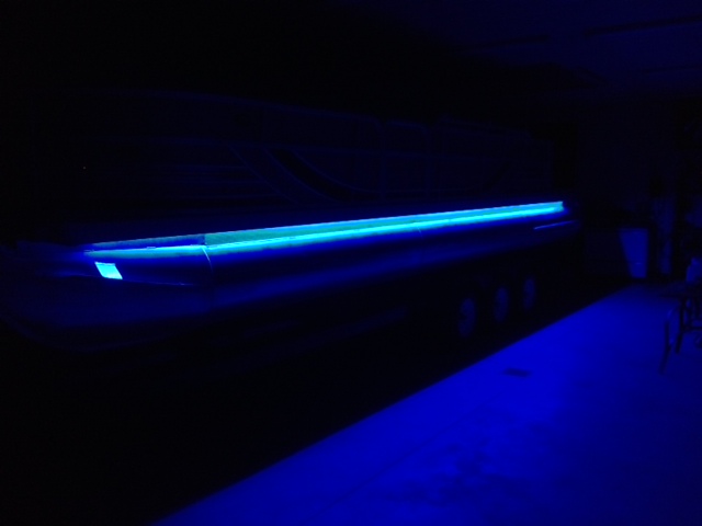

Worked on a few other things this weekend when I wasn't eating, eating more, and eating again. Oh, and throwing back a few cold ones trying to ease that train wreck they called a game :drink4
Got my Under Deck LED lighting kit installed:

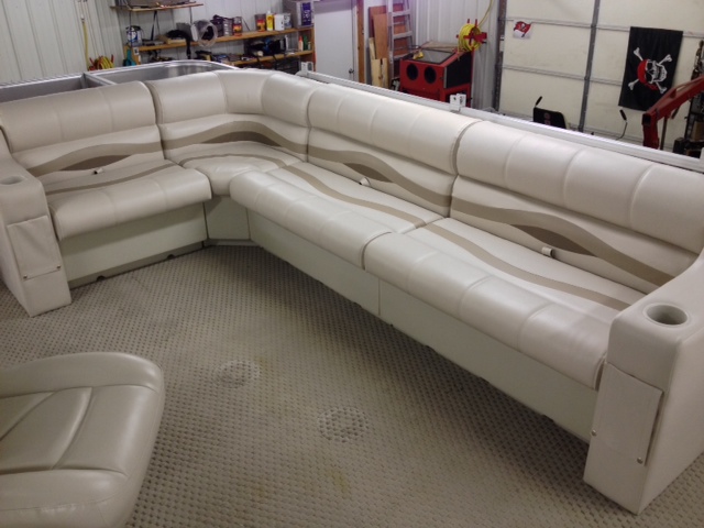

Got my rear L group of DeckMate seats installed as well. Man I love this color :nana

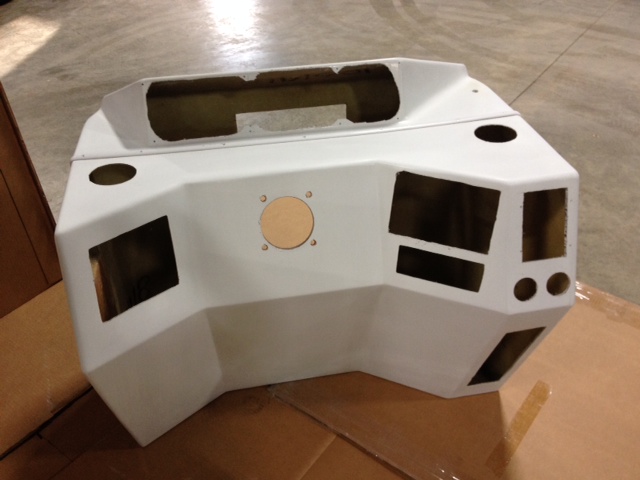

Got my helm :nana
Here I have it all hacked up to fit most of the goodies I need to install. I'm going to give it a coat of paint, the finish is in fair condition and I think I want to contrast the seating any way. HOPEFULLY I'll be able to get some work done to it this weekend :prayer

Wow that thing has some potential! Can't wait to see the finished product.

Is it fiberglass? I was going to buy the big fiberglass console veada sells for my toon, but I want it in grey. My father in law is a painter but he hasn't ever painted fiber glass, what's your process?

Yes, it is Ryan. Painting 'glass is no different really. If it has a good gel coat on it, just scuff it and paint. Really don't even need to prime/seal it. Think about the automotive industry...body parts for years were made from fiberglass, they take paint just fine.
