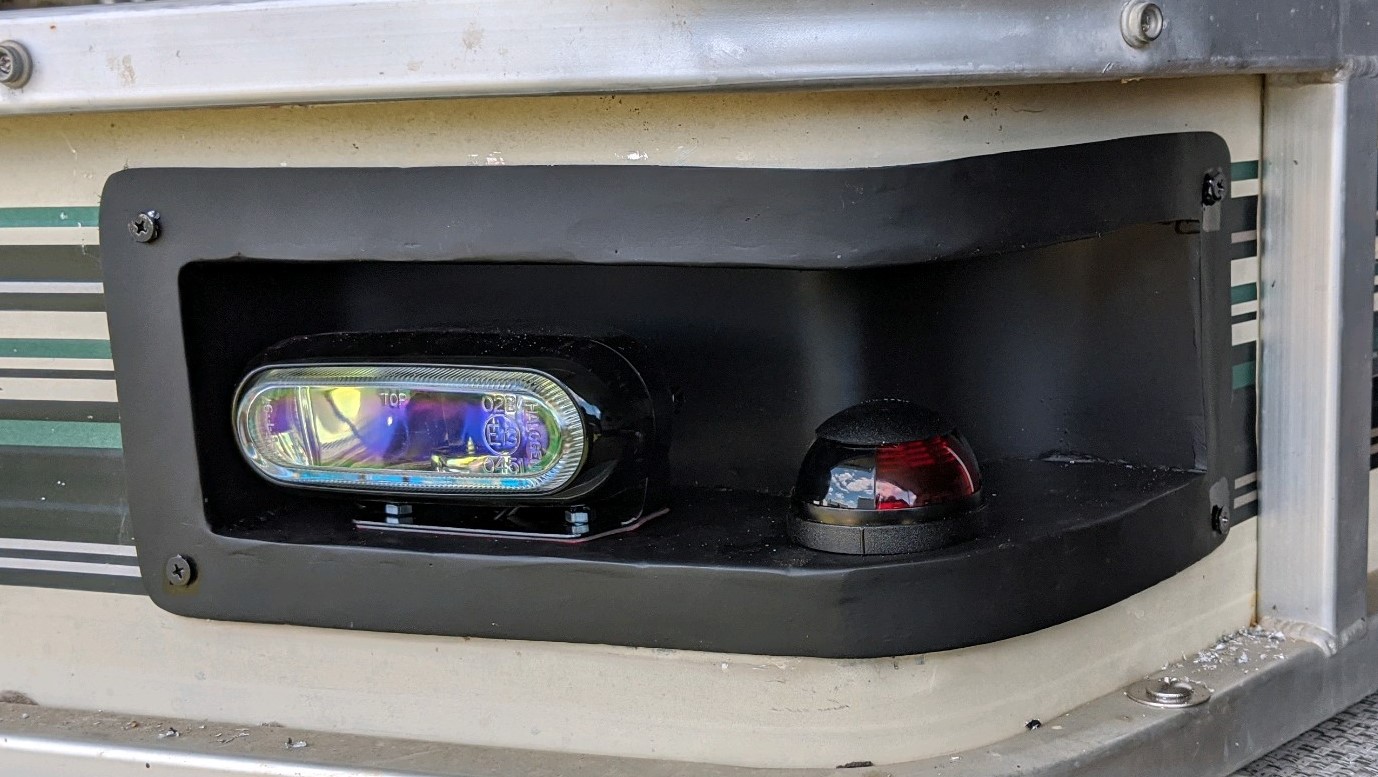

still slow going but making progress. installed the (I dont know what to call them) light "boxes" or "recesses". Wired all the nav lights and fuel sending unit. Still waiting on furniture to be ready. Seems the upholstery shop had a worker get hurt, and of course it was the boat furniture guy, so they are behind.
While not perfect, the light boxes turned out better than I imagined they would. I need to pull the screws and bevel the holes so they sit flush, or at least more flush.

I'm not sure that's the right nav light to have in your recess. That one with Red and green lenses is meant to go in the center of the boat. YOu should really have a red only on port and a green only on starboard

Steve good catch :thumbsup
