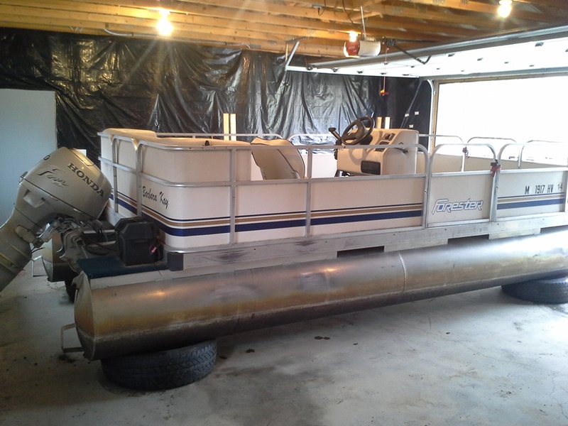

After 14 yrs of summer use without benefit of a cover it's finally time for a rebuild. As part of the rebuild we're also going to change the furniture layout as we don't fish from the 'toon anymore. Here's a pic of what we're starting with, the flip-flop bench had a live well in it. We're thinking of re-using the flip-flop bench (minus the backrest) as a cooler/ottoman that we can push around as needed.

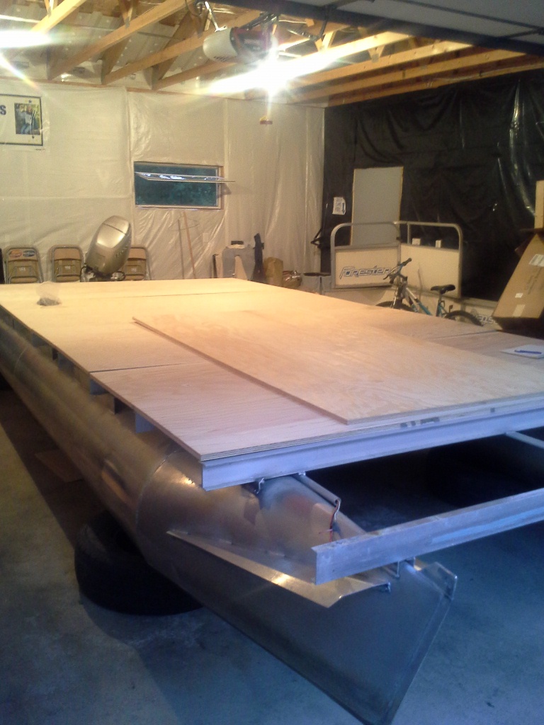

Finally making a little more progress
Deck is coming off
All the plywood is removed, still have to cut off some of the deck screws

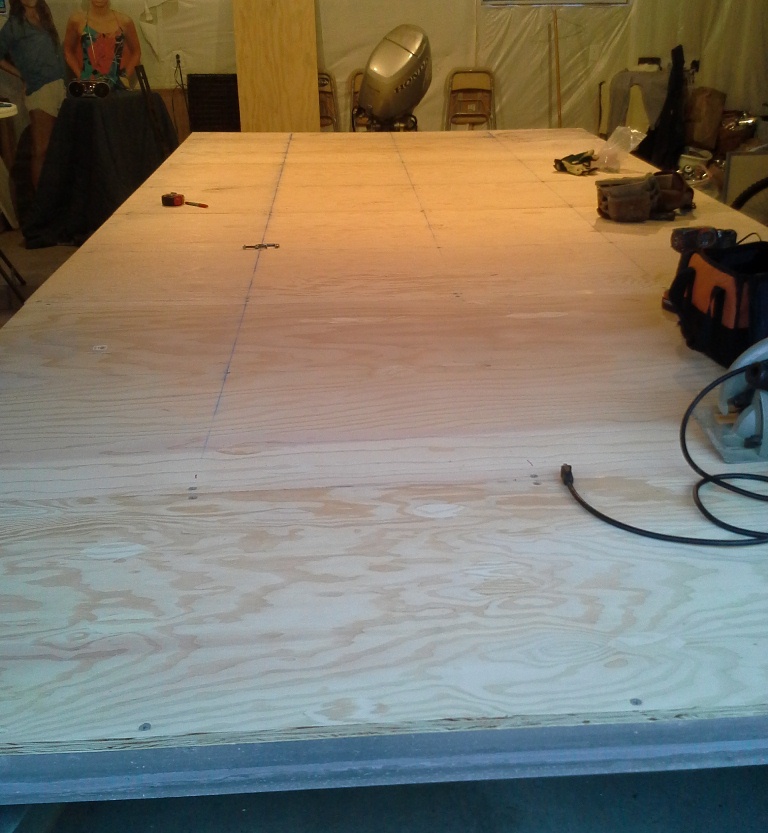

Finally got the 'toon back from the family welder. What should have been a one day job, turned into three weeks thanks to weather and other factors.
Started laying down the marine plywood last evening, hope to get time to get it all screwed down on Wednesday evening. Then on to carpet and railings!

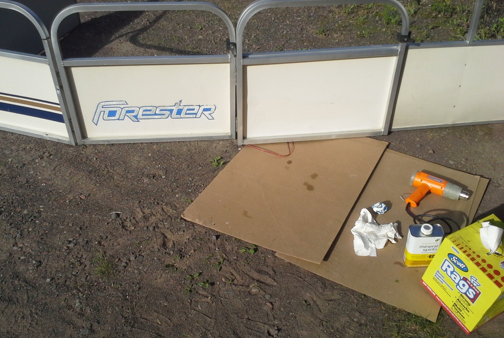

A heat gun and some mineral spirits made quick work of the old gate decals
And one of the new decals installed, yeah the blue finally matches!
