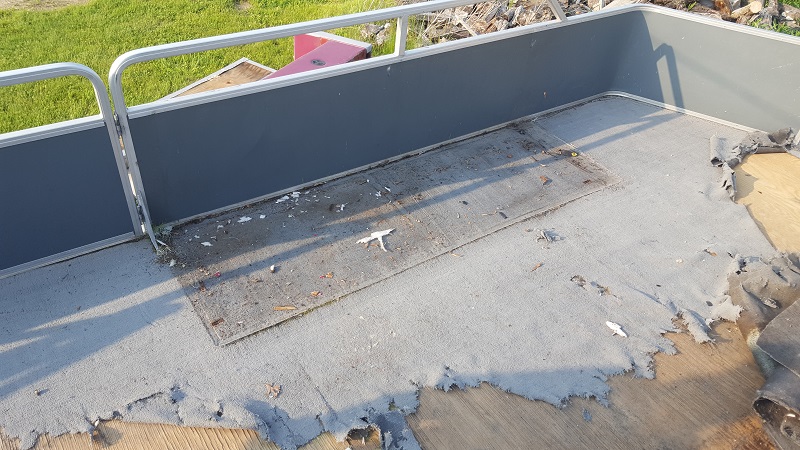

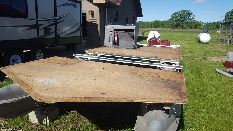

Finally got pics resized to upload

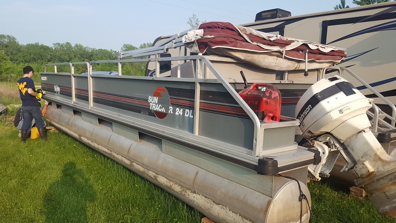

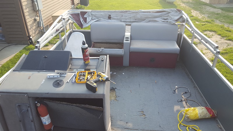

Side View.jpg (192.28 KiB) Viewed 153943 times
top view.jpg (158.95 KiB) Viewed 153943 times
ripping furniture out 1.jpg (185.99 KiB) Viewed 153943 times
ripping furniture out 2.jpg (198.61 KiB) Viewed 153943 times
funiture toss overboard.jpg (228.89 KiB) Viewed 153943 times
drilling fence bolts.jpg (119.42 KiB) Viewed 153943 times
front view.jpg (145.32 KiB) Viewed 153943 times
almost stripped.jpg (175.02 KiB) Viewed 153943 times

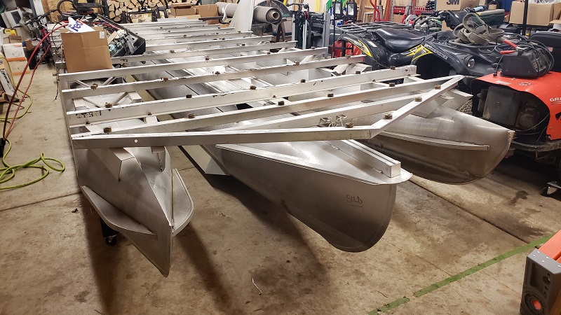

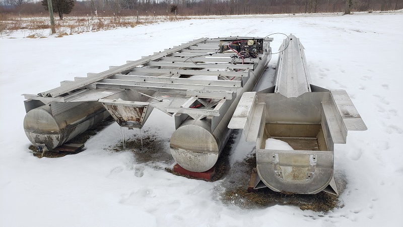

Here's pics of the center toon I picked up
New third toon.jpg (111.27 KiB) Viewed 153943 times
New third toon backside.jpg (136.05 KiB) Viewed 153943 times

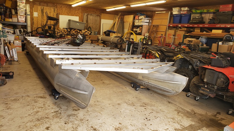

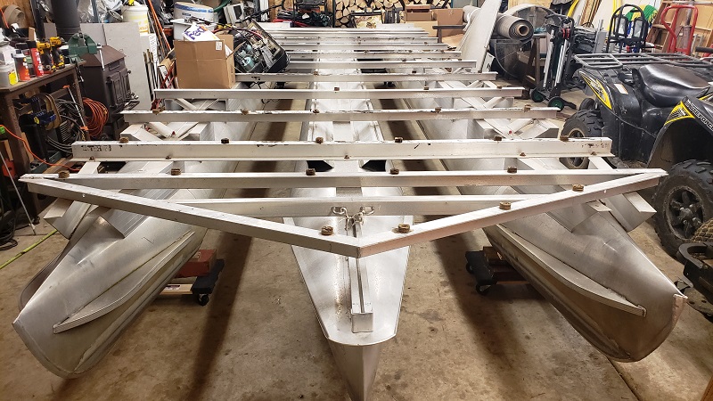

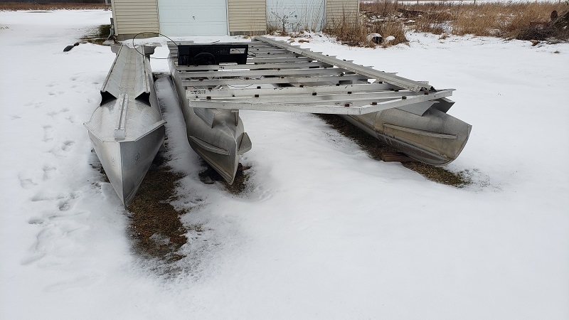

Took advantage of some good weather to move the pontoon into the barn and stage the center toon for measuring. What do you guys think is the best distance to set the transom? Currently it's 18" behind the outer toons.
pontoon in barn 1.jpg (195.7 KiB) Viewed 153943 times
third toon under boat 1.jpg (179.38 KiB) Viewed 153943 times
third toon under boat 2.jpg (191.1 KiB) Viewed 153943 times
third toon transom 1.jpg (155.66 KiB) Viewed 153943 times
third toon transom 2.jpg (109.11 KiB) Viewed 153943 times

Great build, no idea on location. I was going to go back as far as I could so front hits majority of 2aves at same time

The new center tube is 22" longer in length than the factory ones. So right now the center toon is 4" forward of the outers. The rest of the length is out the back.
I checked a bunch of different brands at the boat show and seem to see a split of design. Some have all the toons lined up and a few others have the center toon forward of the outers.
I'm for sure going to set the center toon 3-4" down compared to the outers.

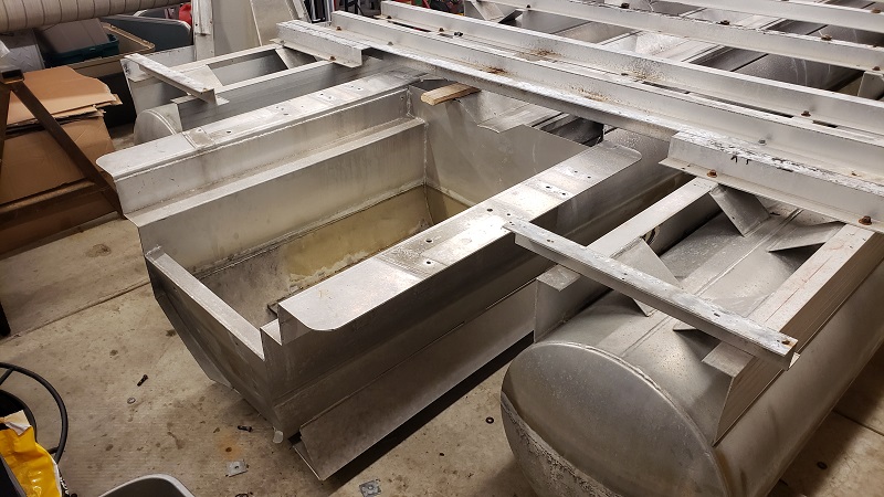

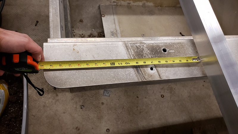

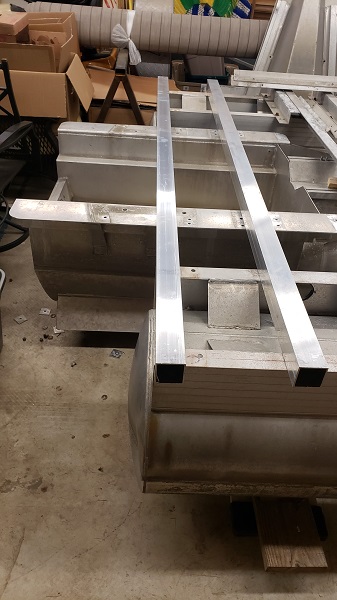

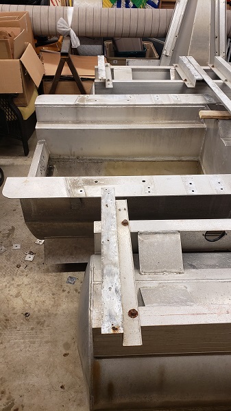

Had a little bit of time to play with the toon last night. I took off the old z bars that were just just supports and placed the box tube across to get an idea of placement and meaurements. I think in the rear I may place the box tubes on 12" centers? Do you all think that is overkill? I would like to hang a 250 or .... :twisted: on the back. The center tube originally had a 300 Verado hanging off it. I also moved the center tube back a few more inches to 20", I think I like this better. Hopefully someone who has done this, can give us a few pointers. Thanks!
Box tube rear bracing.jpg (96.51 KiB) Viewed 153910 times
20 inch setback from rear cross brace.jpg (126.27 KiB) Viewed 153910 times
PaulinOK
Posts: 31
Joined: Wed Jan 29, 2020 10:49 am
Re: 1989 Sun Tracker Party Barge 24DL into Tritoon build
#12 Post by PaulinOK » Wed Feb 05, 2020 11:11 am
I have no experience but I'm just starting a rebuild as well, I've been checking your post and pictures out and one thought occurred to me, if you stick that middle pontoon out in front of the boat will it have any effect on how it sits on the trailer? My initial thought would be to flush the middle toon with with front of the point of the boat, which would stick more out the back, but I know I've seen new pontoons with the motor set well behind the other logs? I am also interested to hear what anyone with experience would say.

With the transom at 20" back, the center tube is now 2" forward of the outer tubes. I need to purchase a trailer here soon. That will be something I look into. I may buy, if I can find, a used pontoon trailer and make my own center supports. I will have to see how the weight distribution goes and make sure I have proper tongue weight. Good point to think of!
