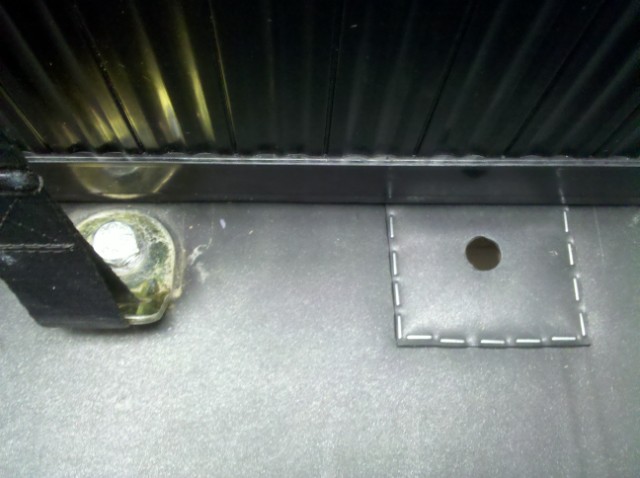

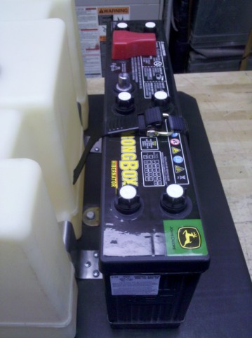

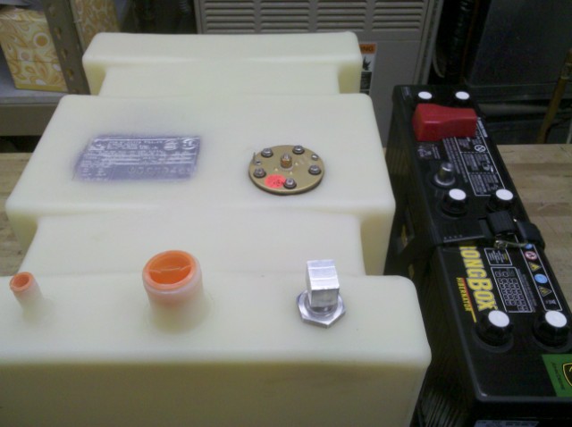

This should do the trick...
All of the power cables emerge from the rubber membrane covered floor (yep, those are stainless steel staples) at the rear of the battery, so there's nothing between the tank and the battery. Since a bulkhead isn't required between the fuel tank and battery I decided not to take the time to engineer one. I'm pretty comfortable that 1000 lb. test Nylon strap with a locking cam buckle will keep that bad boy from moving around and coming into contact with it.
The only thing I need to do now is fabricate a spill tray for the battery. Could NOT find one for an oddball 3ET battery like this one.
Good thing I've got a friend that can weld aluminum.
This battery will power the engine, helm, position lights and two Hobbs 4 amp halogen headlights for night running. One is a spot with a 1000 ft. reach and the other a rectangular 25 X 50 ft. flood. All other power is supplied by 2 standard deep cycle batteries with 90 watts of solar panels keeping them happy.
