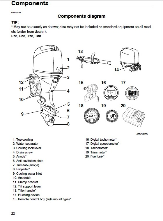

#14 Post by GregF » Thu Dec 08, 2011 2:47 pm
Yamahas don't have an oil drain hole. WTF! :x
1974 Harris
70 HP 4 stroke EFI Yamaha
Bamby
Posts: 1409
Location: Near Wheeling W.V.
Re: Yamaha and Mercury
#15 Post by Bamby » Thu Dec 08, 2011 5:15 pm
Greg the drain plug on yours is in the same exact place as my 90's is. See #4 in the photo below.
