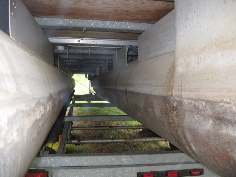

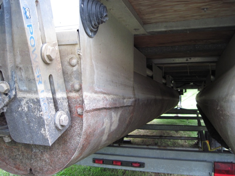

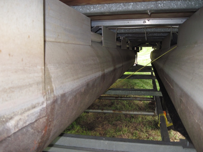

I added a third pontoon / transom to ours that was taken from a 28 ft. party hut and utilized on our crest.

The sch. 40 was used as conduit to protect the control cables and all electrical from potential damage as far as feasible towards the front of the boat. Where the physical mating of the existing cross members and supplemental third pontoon was infeasible, supplemental quarter in. aluminum was utilized as a supplement to provide a secure attachment of the pontoon.

Galvanized stringers!
I wondered who could actually have then.
Cold water in a lake I guess.
In 88 degree salt water they will be gone in a few years. That is why I had to tear apart my Harris in the first place. The original owner had this boat in Wisconsin (Minnesota or one of those frozen places) and a few years after he moved to Florida it was toast in spite of copious amounts of paint.

I happen to agree with you, but you also have to remember that maybe one in a thousand pontoon boats ever see any salt water usage. And you have to admit they're in pretty good shape for being just a year or two shy of forty years old (1972 boat). In the freshwater usage this boat has always seen I wouldn't be surprised if they didn't hold up another forty years.
