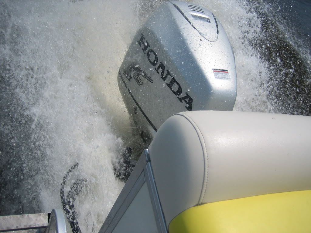

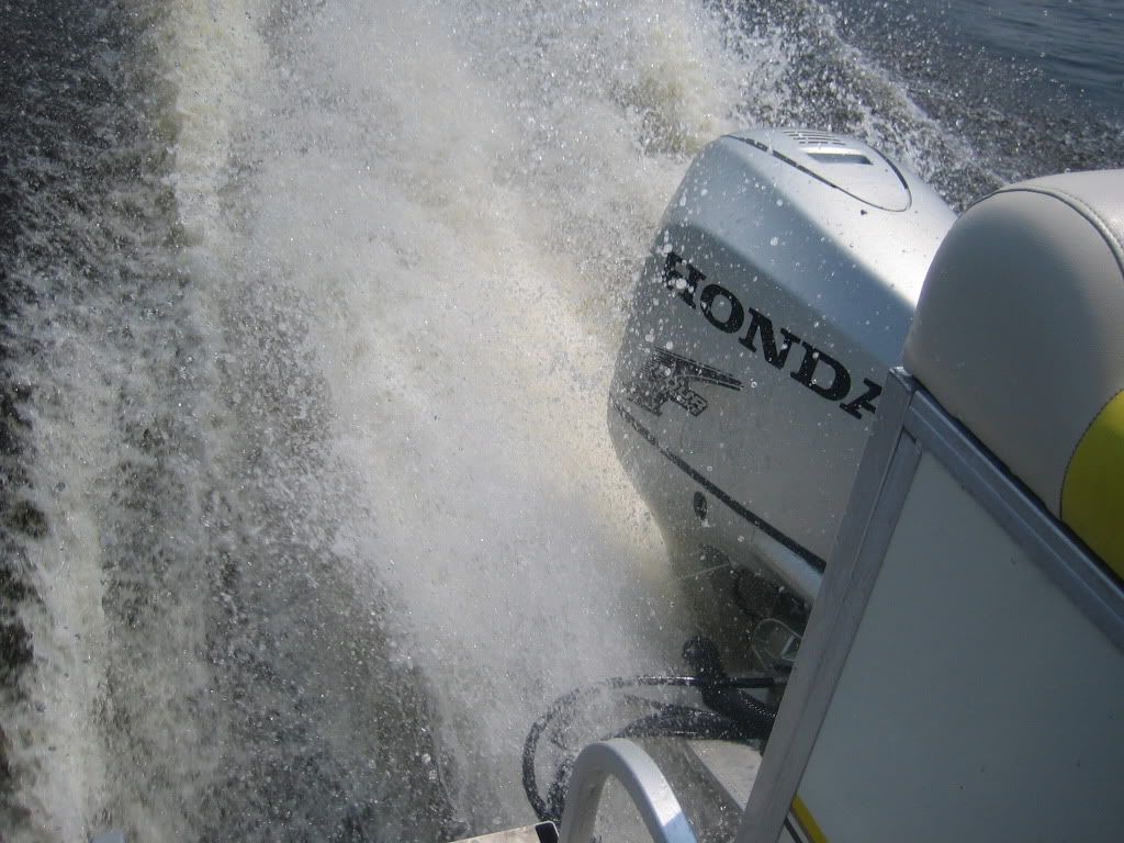

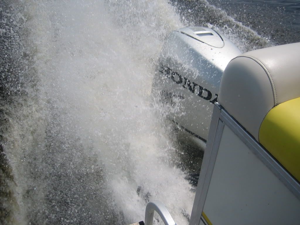

Here are a few pictures. I have so much spray going on it is hard to say if the cavitation plate is at or slightly above the water. The Honda is a short shaft and presently is set as low as it can bolt straight up.
While I also doubt the previous owners but he really had no reason to lie other than pure ego. He didn't sell me the boat. He lost his job do to his inability to work after a bad car accident and had to turn the boat back into the finance company. The boat and trailer went to one finance company and the motor to the other. I am a car dealer and purchased the boat and trailer at an auction and that is why I repowered it. I tracked him down and he was nice enough considering the situation to discuss what he had powering the boat and how it worked for him.
I do not care one bit about doing 62 mph. In the 40's would be nice if needed but my main problem right now is that the Honda 200 is not reaching its optimum rpm range of 5800 rpms.

It's hard to determine really anything from all the wash in the photo's and the their angle. But it does appear that you may not be utilizing the trim properly. At speed especially the motor should be trimmed up a bit to create some lift on the front of the boat to get the best performance and speed.
But their seems to be maybe
be other potential issues that may also need addressed. If you trailer your boat could you post some additional photos of the back of your boat, and transom, from some various angles to see if we can sort this out a bit.. Maybe someone could then spot the potential problem(s).

Ya, from the bottom picture it looks way too low. You can see the spray hitting the Hyd Steering cylinder and hoses. It needs to come up alot. I would raise it as high as it will go, first. Then try it. Instead of the hassle of a jack plate, you can buy a Set back plate for a reasonable amount of money, that will fix it for ya, too. Then you don't have to worry about the wiring, drilling the dash for gauges and switches, ect. I'm actually thinking of doing this, myself. A weekend project for $1400 by the time I'm done. Or an hour project for $200.00. Plus. my new DPMS!

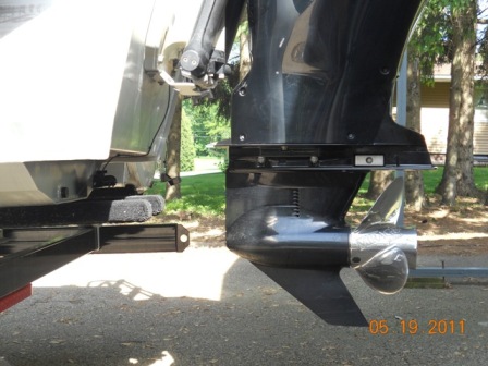

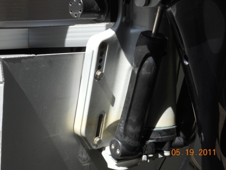

Here are some pics of where mine is on the transom and a pic from the side.
Like Bamby said, get us pictures of the set up on the trailer. One of the transom and one from the side. We can judge it better for you.

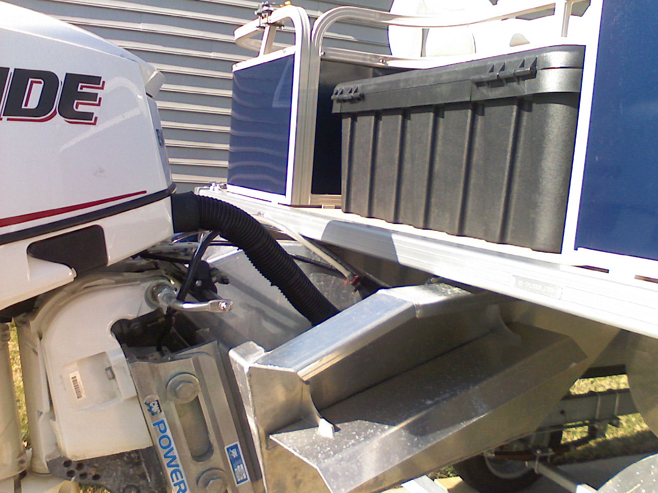

I have a jackplate on my TriToon and love it! It really gives me the flexabiliy to trim my toon just right depending on conditions and load.

You definately have serious issues with spray deflection around the motor. Lots of pics of that underside / motor mount area would be helpful. On our previous toon the steering cable alone made a 1-2 mph difference when we pulled it up out of the spray with a bungee cord. This was back to back A B A testing. You need to consider some sheet metal work for sure.
