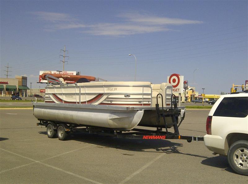

I've been wondering about this for a while, but today I found online a South Bay 722CR with 115hp Yamaha that is a standard pontoon with lifting strakes only on the inside of the tubes.
South Bay 722 CR - $30999 (Aitkin, MN)
My South Bay is long past worrying about warranty, but would it be worth it to contact them and order up a set of their factory style lifting strakes to be welded on? (I would have to find a competent welder locally, I am not hauling it to their facility). Eventually I'd like to add a third tube in there, but taking baby steps here..
Since there aren't any local South Bay dealers nearby, any suggestions on where I can get pricing?
thanks,
-ron

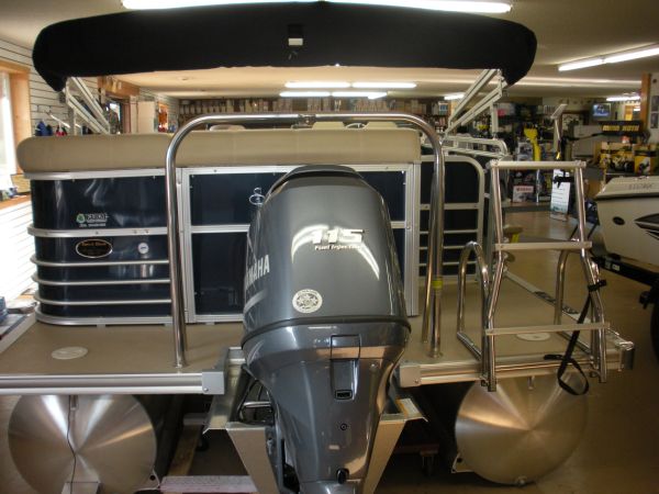

The "sport tube" option you mentioned is sold as a BP1 Performance Package on the Berkshire toons. There are a few members here that have them, and I have one right now too if you want to see any detail pics. FYI the factory was closed last Friday because one of the employees was killed in a motercycle accident. I think it's great that they shut down early to let people off of work to go to the viewing. Not many companies like that any more.
Re: Pontoon with inside only strakes.. worth doing?
Pics would be nice, but how about an opinion, do you think it would be of any great benefit being that it does not provide any additional flotation at the stern of the craft? FWIW, your triple toon package that you sold to tuned is starting to look more and more like a hell of a deal...
-ron
