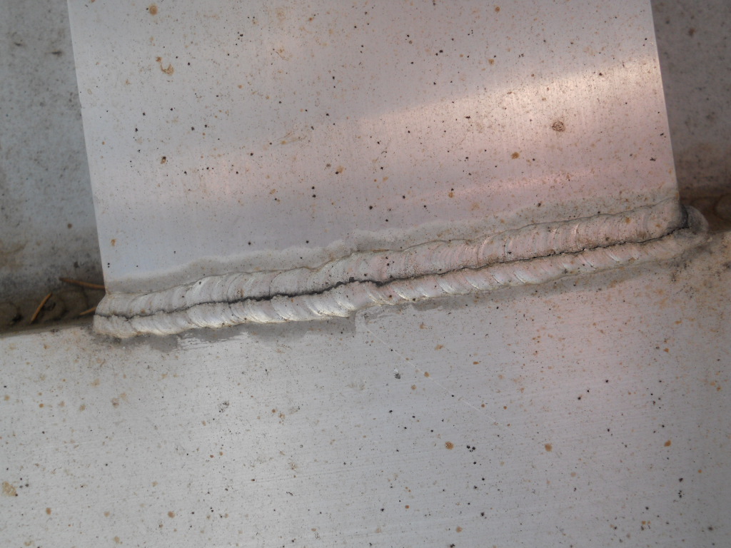

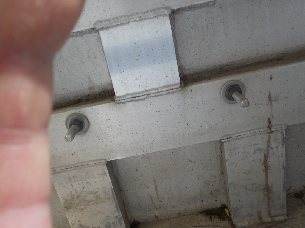

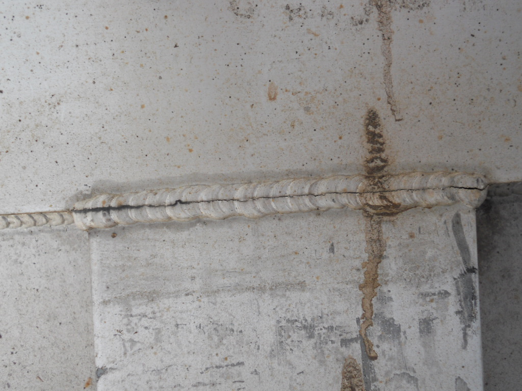

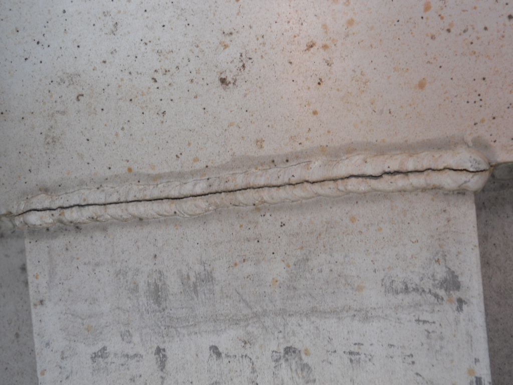

Re: Motor Support/Transom Saver?
to use one? To prevent this! This is my Premier's transom. Been there, done that. Not going through it again. Its on every time, close trips to the river and long trips to the Lake. Its on more than its off!
If you want this? Don't use one.
Why If you want this? Don't use one.
