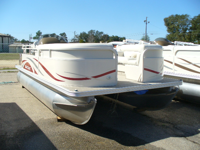

I have a 2006 - 20' with a NEW Merc 90 4 stroke. I have had it out twice this year and at WOT 6200 RPM I can hardly get out of my own way. Proping is correct cause I have played with different pitches. I have trimmed up and down and all around. I even pressure tested my tubes. Im also being told the front of the boat sits low like its taking a nose dive. No over weight people or tons of baggage on board. I keep thinking poor design on the tubes??? Can anyone help??
thanks
Jaimie
thanks
Jaimie
Re: starcraft 20ft pontoon speed

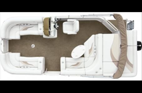

A good speed for that combination I would guess is around 24-27 mph. If your starcraft looks like the ones I found for that model, you may be a little front heavy. With all that furniture and maybe a couple of mates up front, your front end is plowing on a 20 footer. Even the driver is sitting up front on that toon.
On my 20 ft/50hp toon, I can have 2 people up front going 16-17 mph, move them to the back and increase to 18-19mph. In the best conditions I can get 21 mph. My boat doesn't have much furniture up front.
Post some pictures
On another note. Cold water is denser adding lift to the logs and bite to the prop. And cold air is also denser making is easier to get more into the engine.
Post some pictures
