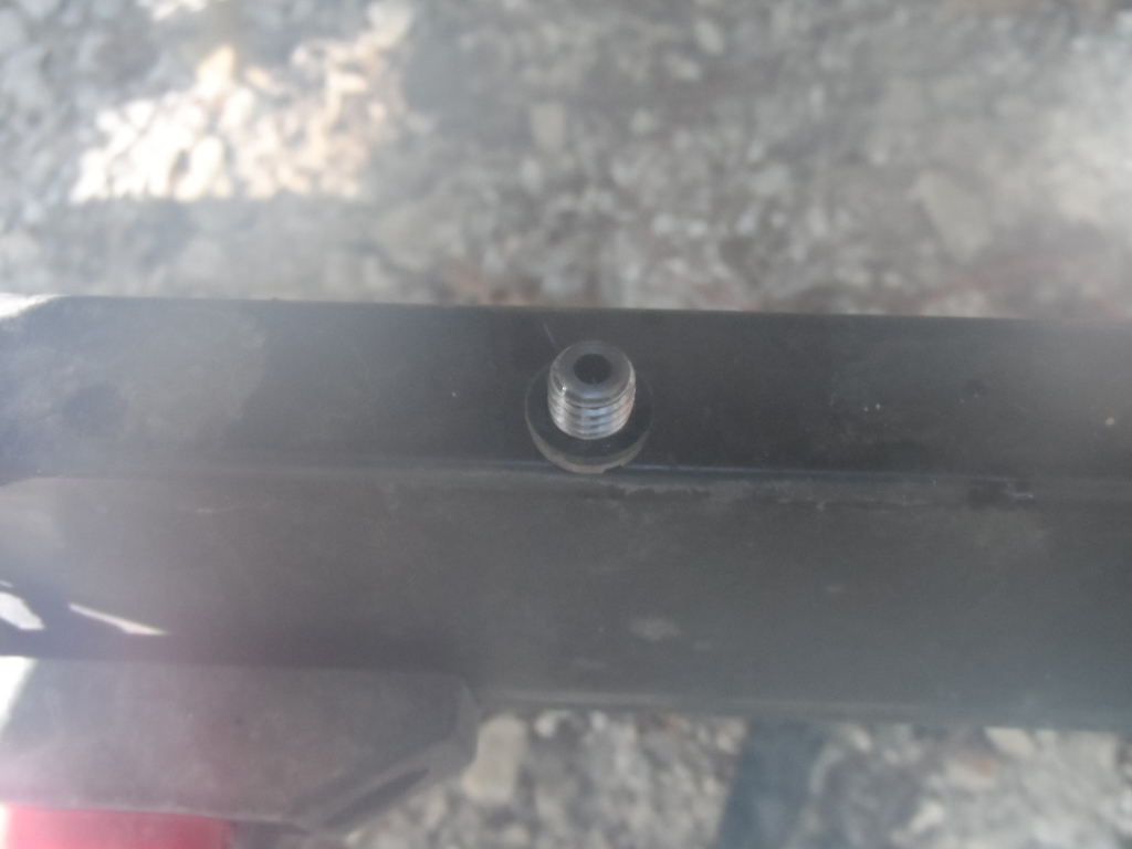

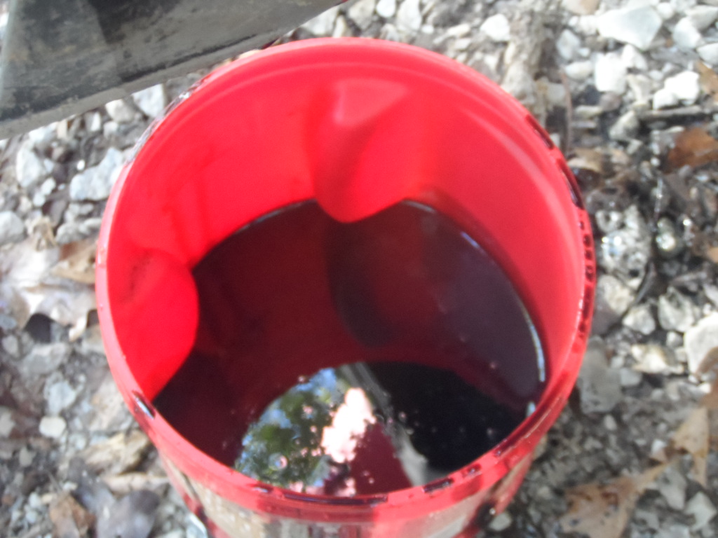

I went ahead and opened up the lower unit plug to check for metal shavings luckily there weren't any so I will be messing with the linkage next. The LU oil was black as night and not a sign of milkiness!
