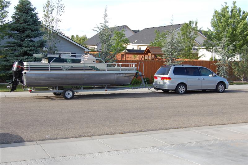

- mini-boat.jpg (84.98 KiB) Viewed 10290 times

Obviously it can be done, but I agree with most. It is not the most advisable thing to do. Strongly consider finding something a little more suited to the task. Adding a towing kit, probably only $300. Adding trailer brakes $1000. A new transmission or having an accident (tough to put a price on!).
