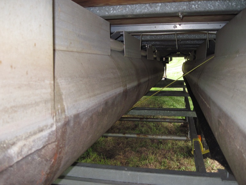

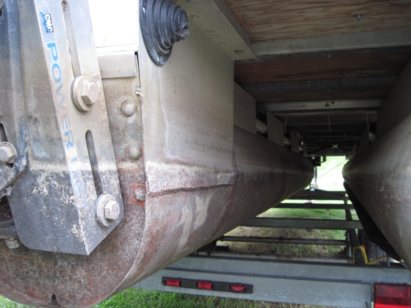

I added a third pontoon / transom to ours that was taken from a 28 ft. party hut and utilized on our crest.
The sch. 40 was used as conduit to protect the control cables and all electrical from potential damage as far as feasible towards the front of the boat. Where the physical mating of the existing cross members and supplemental third pontoon was infeasible, supplemental quarter in. aluminum was utilized as a supplement to provide a secure attachment of the pontoon.

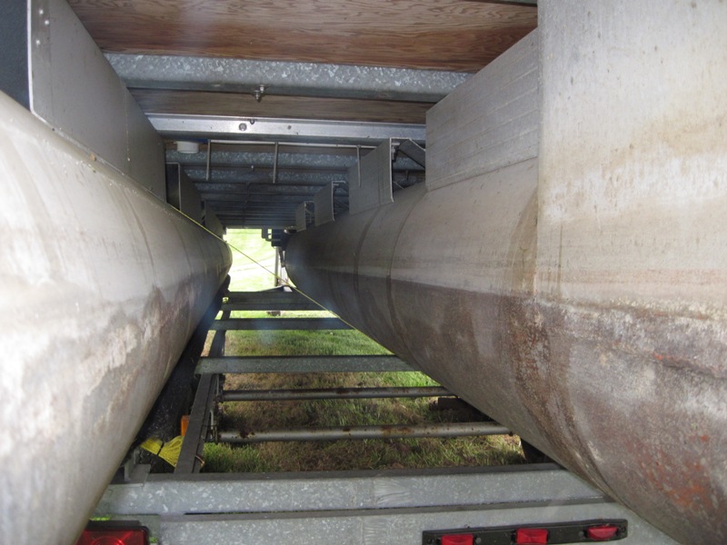

Galvanized stringers!
I wondered who could actually have then.
Cold water in a lake I guess.
In 88 degree salt water they will be gone in a few years. That is why I had to tear apart my Harris in the first place. The original owner had this boat in Wisconsin (Minnesota or one of those frozen places) and a few years after he moved to Florida it was toast in spite of copious amounts of paint.

I happen to agree with you, but you also have to remember that maybe one in a thousand pontoon boats ever see any salt water usage. And you have to admit they're in pretty good shape for being just a year or two shy of forty years old (1972 boat). In the freshwater usage this boat has always seen I wouldn't be surprised if they didn't hold up another forty years.GregF wrote:Galvanized stringers!
Re: Post some pics please!!!!!!!!!
That may be true. I imagine most real salt water areas are not that pontoon friendly but they are very popular here on the Florida Gulf Coast. In my community about half the boats are pontoons. A lot of it has to do with how well they do in shallow water.

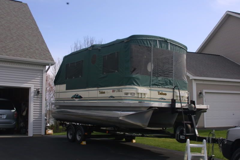

nonfactory??? LOL I have a few
full enclosure

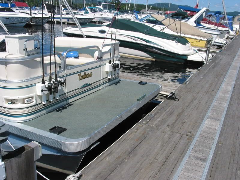

down riggers and rod holders (better rod holder photo to come)

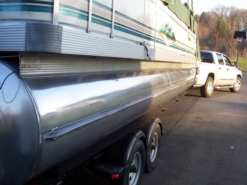

polished and shark hided(needs it again!)

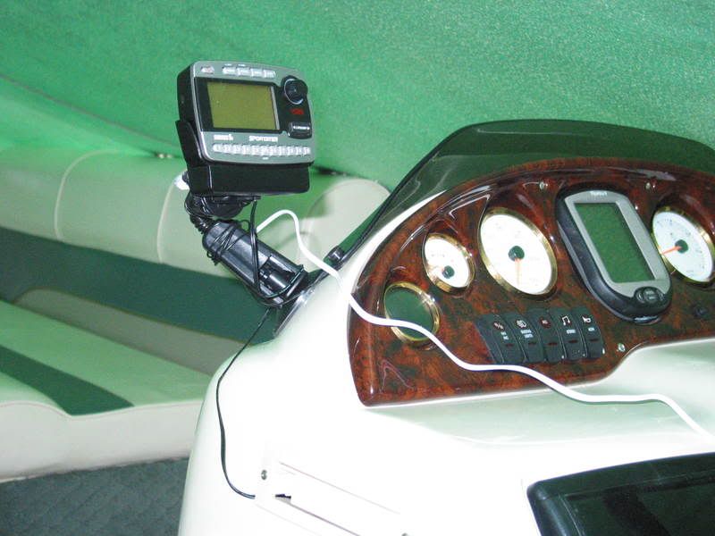

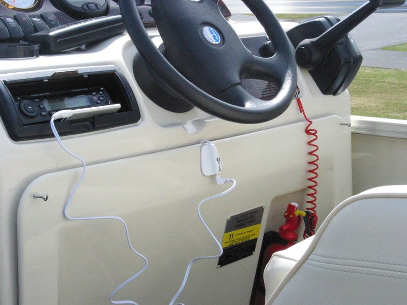

sirius
Aux connection for my stereo

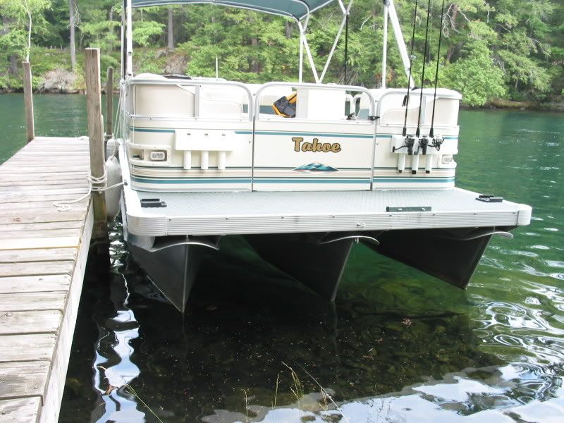

added the 3rd pontoon
as promised, the rod holders

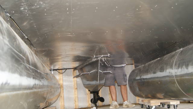

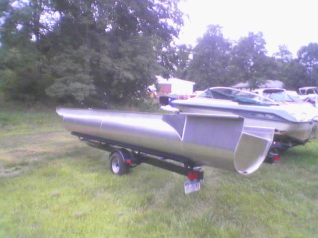

3rd pontoon prior to installing

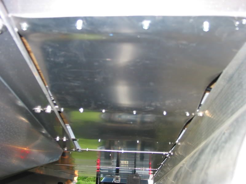

underskinning

Underskinning!!!!!!!!!!

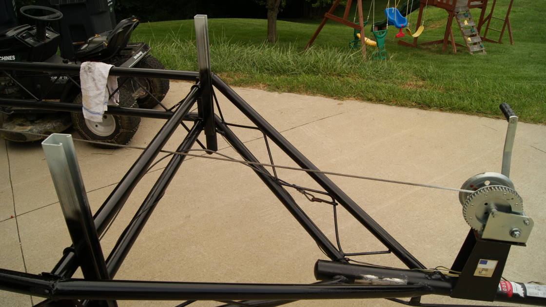

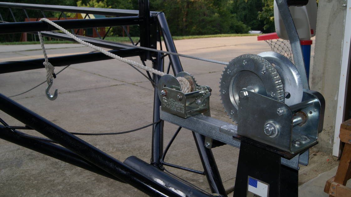

If you have a Hoosier up/down trailer here's a great mod. Big metal stop rails and a winch line to pull the boat up on the trailer.
If you have the hoosier trailer you know what I'm talking about
