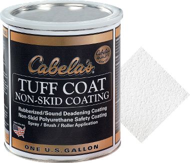

I know how you may feel about carpet, I felt the same way. I used this product pictured below on one of our boats.
cabela's tuff coat.jpg (29.2 KiB) Viewed 3823 times
I followed the directions to the letter when I applied it. It was good looking at first but within a year it was starting to fail. The product at first was showing hairline cracks in the finish and proceeded to peal off to bare wood. I ended up removing it this fall in fact and treated the wood with wood preservative like you'd use on a wood deck. Now I'm not actually recommending you should use wood preservative yourself because I'm uncertain as to how long or well it would hold up. But I wouldn't recommend the tuff coat above or the same or similar under different labels. With the application window and care I took applying it I'm confident it wouldn't hold up for anyone in real world conditions, at least on marine plywood.

Even the truck coating don't like to be applied to bare material, they like to stick to coatings instead, you need a primer coating for it to stick too.

Herb,
I followed the directions including the part about a good quality exterior primer (Sherwin Williams) . I also tented it up with plastic and a tarp to protect it from moisture and dew for a week as the directions stated. It was installed right with maybe the perfect weather window and failed it simply isn't a good product, even at about 70 dollars a gallon.

So just a bad product then, that's sucks when you do every thing right and it still doesn't work.

I think these deck liners are made to go over metal. Wood probably feeds too much moisture in from the back side
