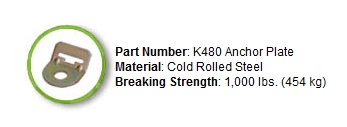

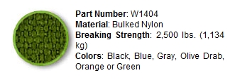

I wouldn't do it either with a garden variety battery and mount, but that particular battery case is about 4 times as strong (and 4X as expensive) as a Walmart special and has very robust screw down top plugs. Add in the 2500 lb. test nylon webbing, 1,000 lb. test locking clamp, anchor plates, grade 8 bolts, backup washer and locking nut.
This is the exact same hardware used on nuclear submarines. If it's good enough for the Navy I guess it will work for a pontoon boat.

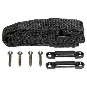

Of course you can always go cheap and get a typical unrated cheesy poly strap, PLASTIC buckle, 4 tiny stainless steel wood screws and 2 PLASTIC footman's loops for $4.29 at Joe's Discount Marine - or buy your Chinese plywood at Loews.
Sometimes you man up, bite the bullet and install quality components where they count.
