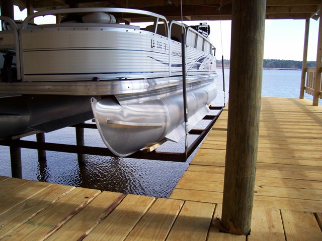

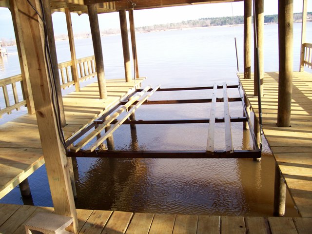

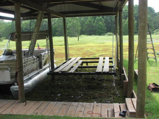

This is how I did mine and don't have any problems with it. Once mounted and when pulling in your boat centers up on the boards. Your boat is too big and long to miss them. It's easier than loading on your trailer. The pictures without the boat on the lift show the boards just laying on the lift not screwed down yet. But it gives you the idea of how we did it. There are a few more like mine. I don't like the idea of mounts holding up the outside edge of the board as when and if the boards rot or break then you have this mount sticking up through your toon.

Ok I give up where is the water?

georgiatoon wrote:Ok I give up where is the water?
LOL...I was thinking the same thing. I now understand why you haven't been out in a few years Jim. What was the reason for the lack of water? I forgot...

Beleve it or not there is 6 foot of water below the boat in the picture. You are seeing the invasion of the Giant Salvania. This started the year the boat house was completed and we are still fighthing it.
That is actually water all the way over to the tree line about 1000 or 1200 feet behind the boat.
