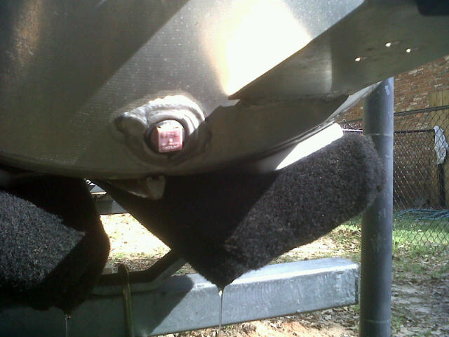

Well, I bit the bullet and ordered the bunk glides for my trailer. The carpet will need to be replaced sometime this season, so, I decided to go with the slides. Here is what I ordered.
I hope to get them installed in the next couple of weeks. I'll let you know how it works out.

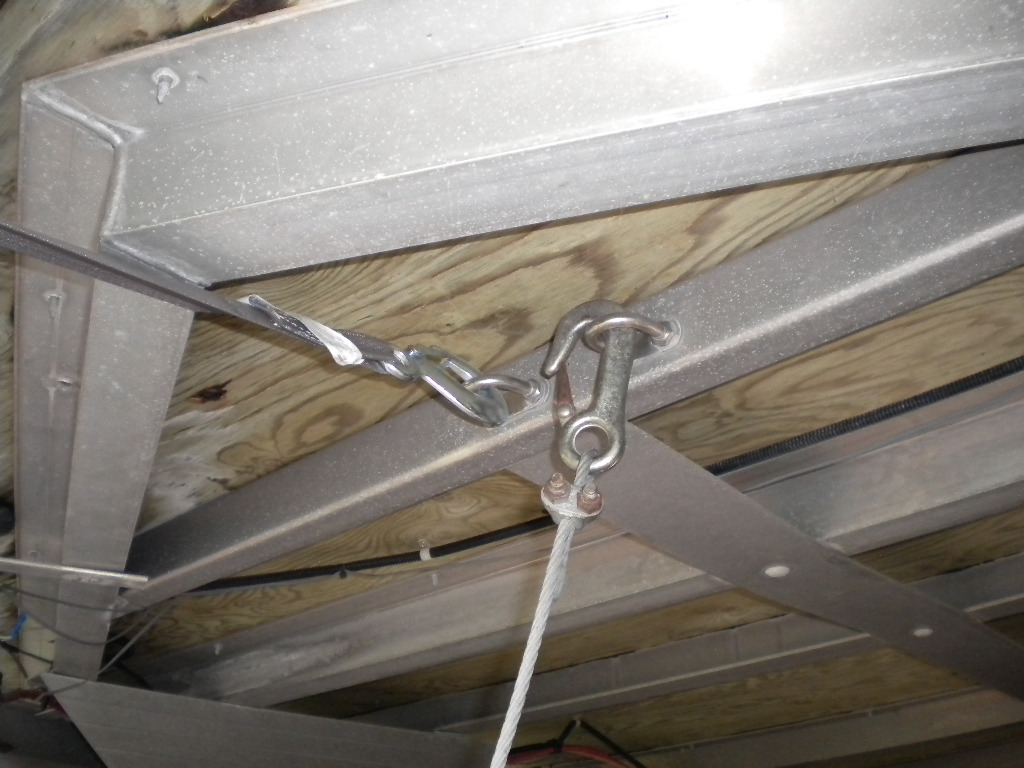

#5 Post by curtiscapk » Wed Mar 30, 2011 7:41 am
here is an idea. it is stock on a tracker :nana

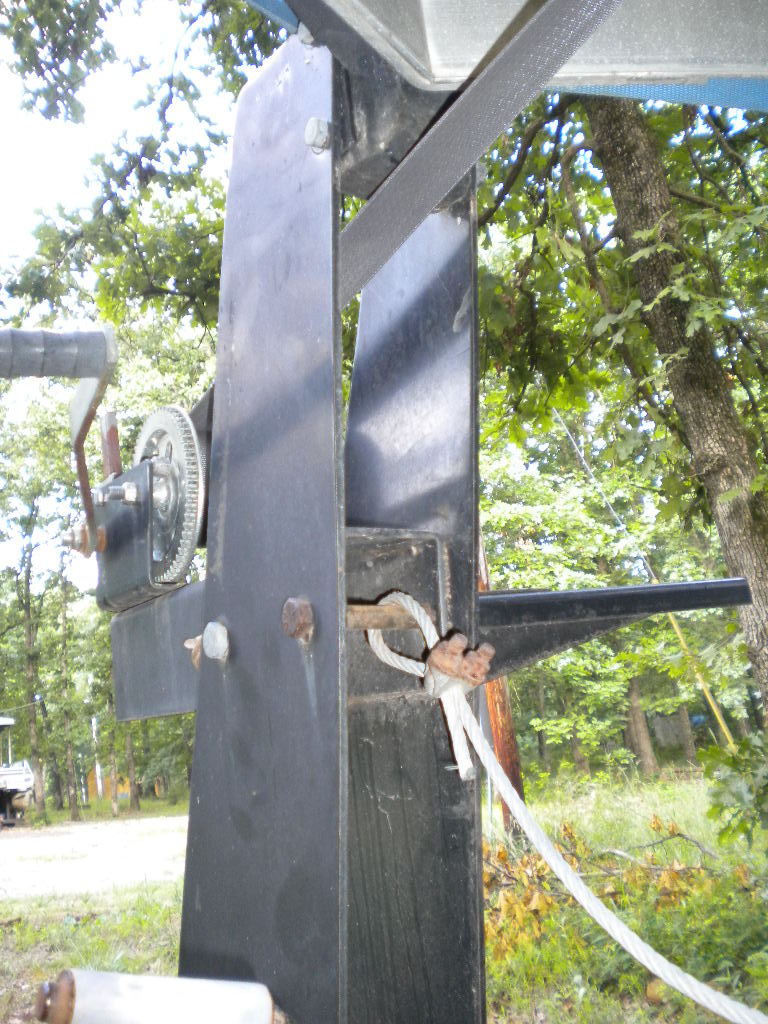

#6 Post by badmoonrising » Wed Mar 30, 2011 8:18 am
Is on my trailer too, except it's a chain not a cable.

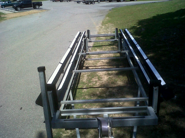

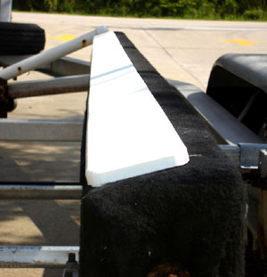

Had a great day on the water. It was a bit windy, even had white caps in the main channel of Lake Oliver. My son Michael and two of his buddies went tubing even though the water was only about 74 degrees. They took me back to the marina and I put the slides on the bunks of the trailer while the guys took the boat out for one more round of tubing. IT took me about 45 minuttes to an hour to get it done and put everything away. The slides seem to work great. Michael put the boat on the trailer first time even with a cross wind. Once we got it out of the water, I was able to crank it up a couple of inches to snug it against the front stops without much strain on my winch strap. I am anxious to see how they work the next time I launch.

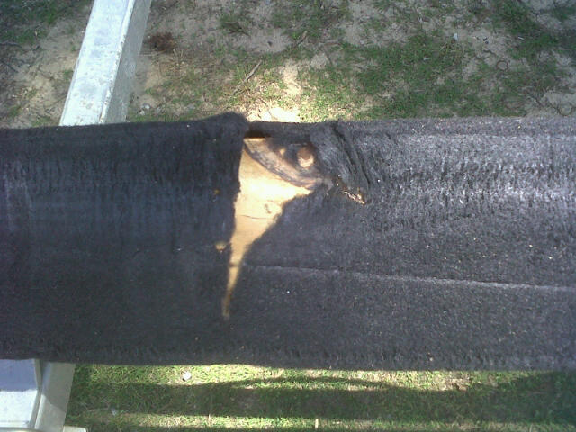

I was concerned that the slides were only 3 inches wide, but when I took a close look at the wear pattern on the carpet, it was only about 2.5 inches wide. Once I got the boat loaded, the toons are sitting on the slides and look fine.

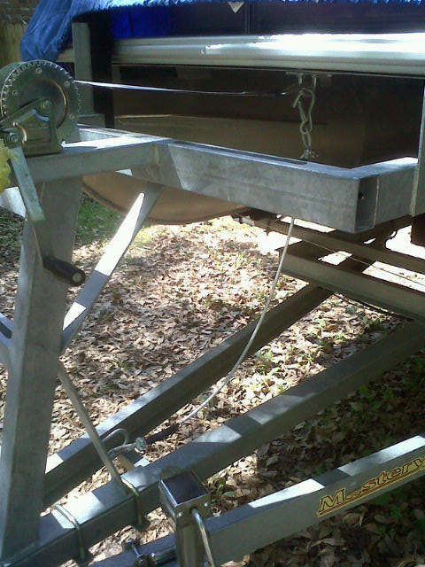

Here are a few pictures of the slides. I have also posted a picture of the safety cable I added to my trailer. I just went to Lowe's and bought the cable, two cable clamps, and one hook. 20 minutes and it was done.
Safety Cable.
End View.
All done.
One side with the slides installed.
Torn carpet before the slides were added.

I've been thinking about this same thing due to needing to replace my bunk carpet. Does anyone think there is a chance of the glides denting or creasing a pontoon? That's been my hold back doing this. I also like the idea of just replacing the bunks with Trex or something similar with no carpet.

That was my concern too, but once I looked at it closer, the toons only hit 2.5 to 3 inches of the bunk anyway. They make a wider slide, but this is what the guy at the dealer sais most pontoons used.
I am not sure Trex can span that far without sagging. It is made to go on 16" center supports. Maybe someone else has experience with it.
