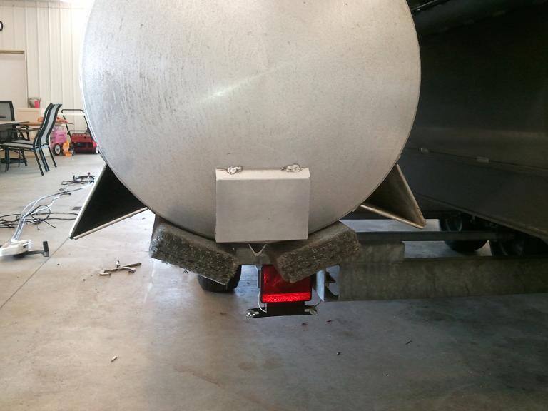

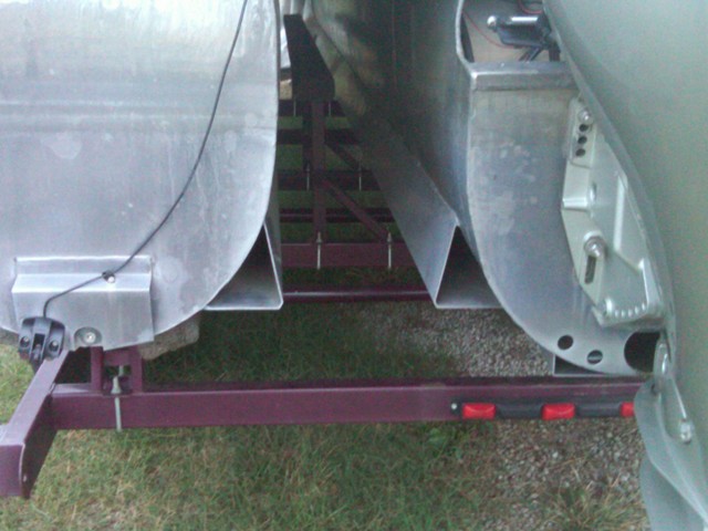

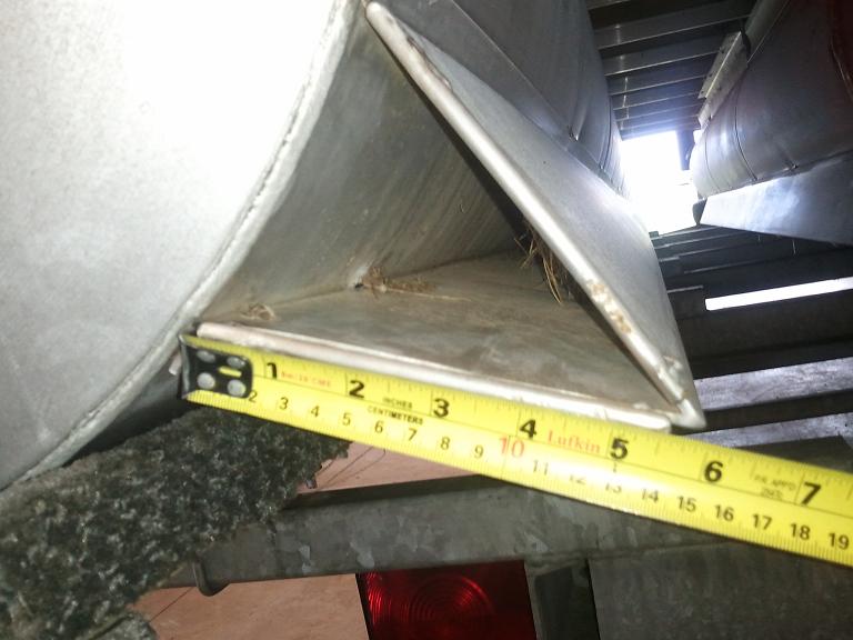

FWIW, here are some pics of my strakes and I agree with BMAC:

[quote="The_Hellbilly"]FWIW, here are some pics of my strakes and I agree with BMAC:
Are these factory strakes or did you have them added aftermarket? I really appreciate you putting these pics on here for us!

- The_Hellbilly
- Posts: 930
Re: Lifting strakes
Spurhunter: those are factory from Voyager. IMO they don't seem to be too complicated. I took the pics last year when this topic came up, but was too lazy to dig up the old post.

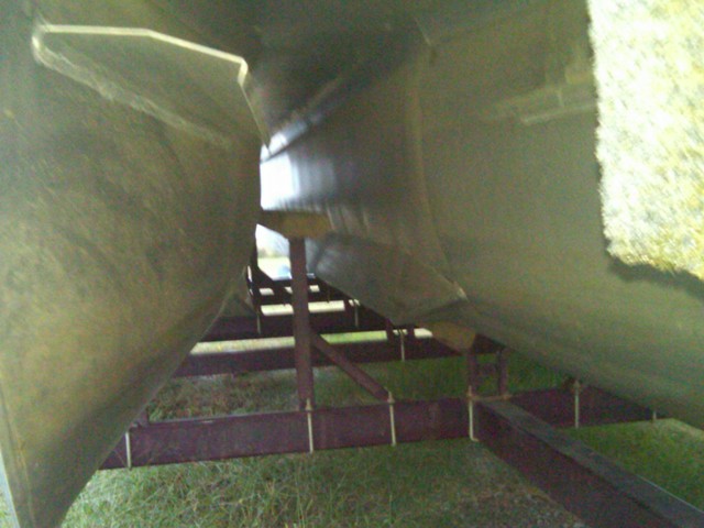

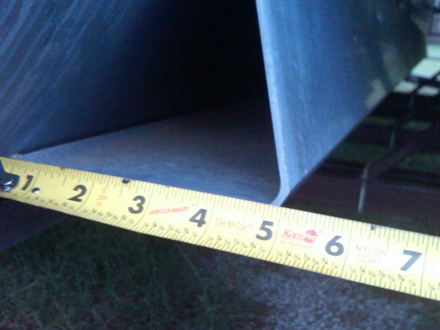

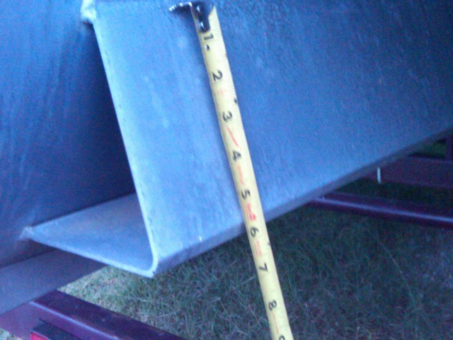

Re: Lifting strakes
Factory installed...
- 2011-05-29 11.12.00.jpg (61.38 KiB) Viewed 10630 times
- 2011-05-29 11.09.57.jpg (55.18 KiB) Viewed 10632 times

What brand of boat is that?ToonGuy wrote:Factory installed...
