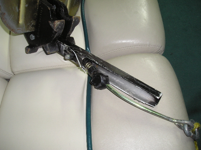

Speaking of anchors........today for the first time neither one of our Diggers would trip. My wife and I had a really nice day anchored in a cove all day swimming and relaxing. Perfect day until the damn anchors wouldn't trip and we spent over an hour fighting them. After 8 season I found another item to keep on board, gloves. Tore up my hands on the nylon rope
Ended up tying a fender to one anchor rope so we could deal with one at a time, then taking the toon over the anchor in every direction trying to break it free. In theory, once over the top of the Digger you should be able to pull straight up and trip the latch so the anchor will be able to pull straight up. Finally got pissed and just pulled with the motor and that one broke free. Went and got the other one tried to to the same and no matter what it wouldn't trip either. No issues in 8 years and now both go on strike. We just pulled it with the motor except this time it broke the spring loaded arm, split the square shaft and pulled the spring loaded guts out. At least everything stayed together. Gonna see if Digger will sell me the the arm assembly separately. Can't wait til they see the pic
