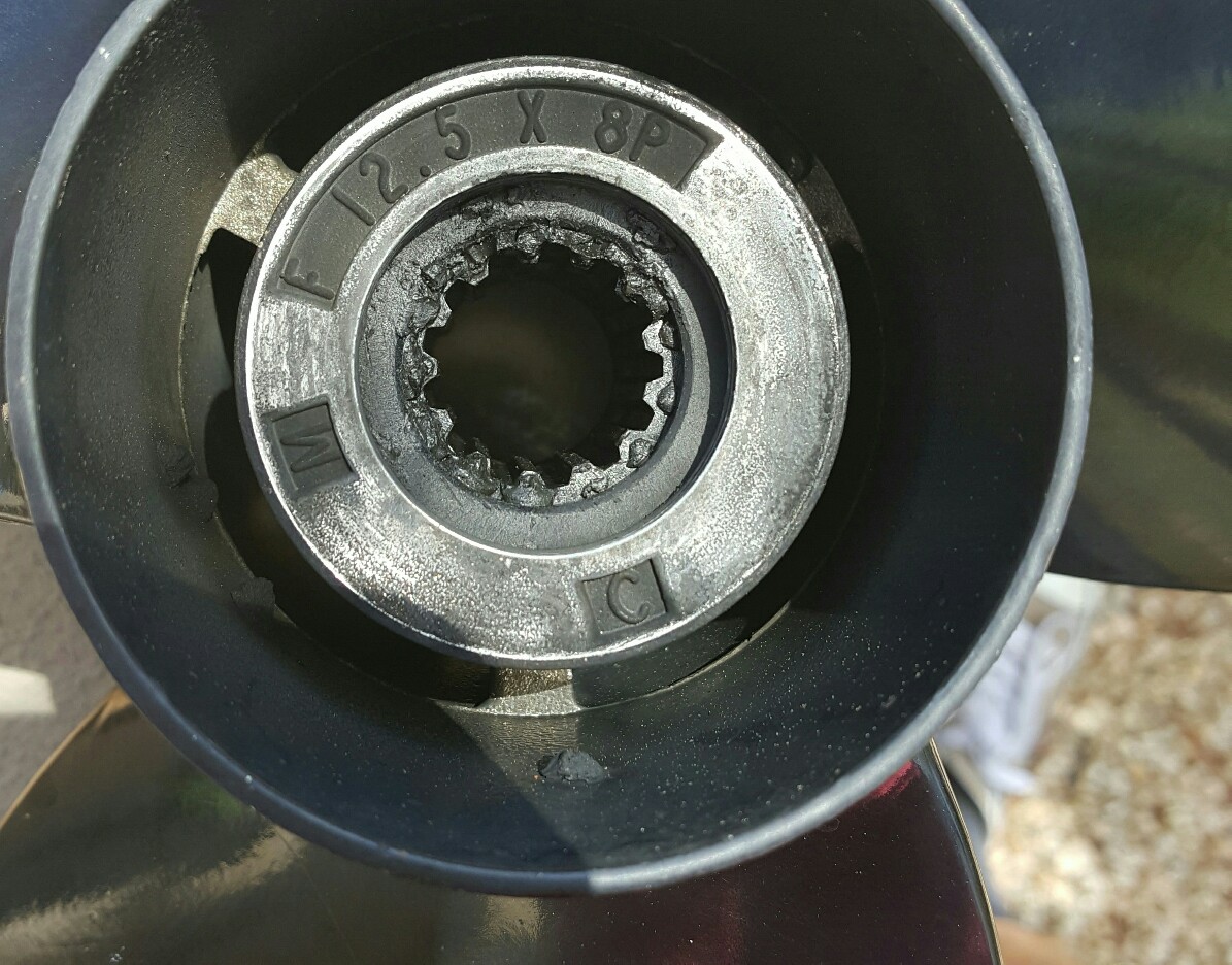

Re: New to Pontoon Boats - Having Issues
This is the prop i have on it now.
- 20160426_124834-1195x936.jpg (271.21 KiB) Viewed 4660 times
- Jake_Daddy
- Posts: 74
Looks like an 8" to me.
I would guess that your 50hp has the 1.83 gear ratio, maybe someone else could confirm that the tracker outboard is not the same lower end as a Bigfoot with the 2.33 ratio.
If that's the case your right where you wanna be RPM wise with a light load and about 25% slip which I would say is in the zone of where you should be. You could probably play with the next size larger prop in the 9-10" range to gain a little top end.
Your in the zone now of where you should be. But if you wanted to mess with it I wouldn't buy a prop until I played with motor height. If you tinker with it and get a few more rpms then you could have a better idea of what prop to look at.
That diameter seems a little small. Is it a standard or Bigfoot? I think most 50 bigfoots I have seen are turning around a 13 pitch and around a 14 diameter.
[quote="mpilot"]That diameter seems a little small. Is it a standard or Bigfoot? I think most 50 bigfoots I have seen are turning around a 13 pitch and around a 14 diameter.[/quote]
No it is not a bigfoot
