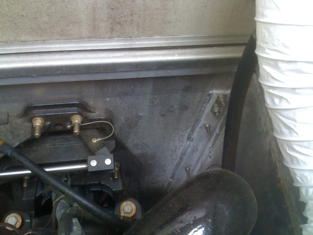

I took a look into the engine compartment today (not sure why I didn't before), and saw the back side where the U bolts we connected tube rope to were. Does this look sturdy enough? We didn't have any problems and I didnt see any stress cracks or bolts pulling or anything.... but like another opinion on if this is a safe place to connect Y tube rope to. Here is picture where the one on the right comes through in engine compartment:

That should be fine. I would prefer larger washers, but since it is bolted right through a doubler plate that will spread the stress over a larger area.
