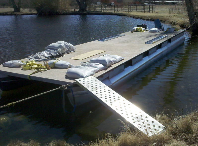

I'll have to agree that submerging is the BEST, SAFEST and only foolproof way to find leaks. That's exactly what I did with mine when I took ownership of my derelict 1988 Party Hut - and before I started a year long build.
It's EASY to submerge one side at a time by simply piling sandbags on that side, it took 20 (a bit over 2,000 lbs. since I had the large size) to completely submerge mine. Sand is cheap, sandbags are cheap. I hired a couple of teenagers to fill 'em and pile 'em on while I drank beer. Look for the bubbles, then jump in with a dive mask and circle the spot(s) with a black wax dish marking pencil.
If you went the pressurization route Leak-Tek detection spray is dirt cheap and FAR superior to soapy water. It's what professionals use. It will provide LOTS of bubbles on even the smallest leak. A lot of the leaks come from cracked welds where the log attaches to the mounting bracket - they're sometimes almost impossible (especially on the inside of the bracket) to see without a telescoping inspection mirror and bright flashlight.
