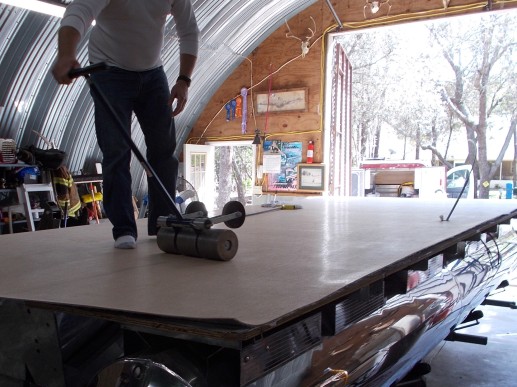

It is easy to do, the most important thing besides the temp is using a heavy roller on it

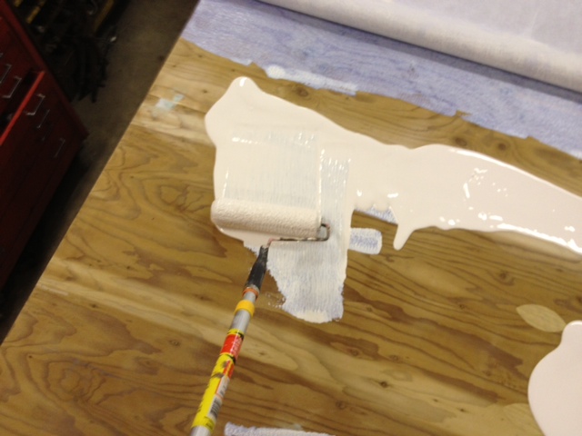

If you are installing Marideck vinyl follow these tips...
Photo 1: Prep and clean the deck. Sweep it and if you can blow it off with compressed air. Roll out the vinyl nice and straight, then roll it back on top of itself just over half way.
Photo 2: Pour your glue on to the deck, and begin rolling it on with a medium nap paint roller.
Photo 3: Roll the glue on as thick as possible with out creating pools or puddles.
Completely cover the first half of the deck, roll out the vinyl, roll it back from the other end and repeat.

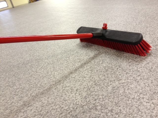

Photo 4: After you have the deck completely glued and your vinyl all rolled out nice and straight, take a stiff bristled floor broom and work the vinyl from center out. Overlap your strokes. Walk around the boat on the ground repeating this step at least 3 times. It's important to stay off of the deck...foot prints may show later. If you have any drips or runoff you can clean it with a damp cloth.

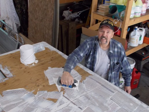

I guess we had a different glue, ours had to be spread with trowels

Herb: Yep, a different formula on the older glue. But the biggest difference is the flooring. It looks like in your picture you have the Alpha brand flooring. It is a totally different beast than Marideck, that's why I mentioned the brand in the first sentence. Marideck is much much thinner and more pliable than other brands of vinyl. A roller can actually trap air under it.
My method has worked better, for me, than any other way of installing Marideck. For most other brands of vinyl use a roll like Herb pictured, and ALWAYS for carpet!

Everyone beat me to it on the 100 lb. roller. Any floor--vinyl or carpet--needs to be glued down with the correct mastic and it must be rolled.
I once put down a vinyl floor with the wrong mastic, and had to remove, re-glue and roll the floor with the proper glue.
