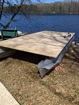

I replaced the old deck on my pontoon with all new marine plywood -- it's now raw plywood. I'd like to paint it rather than add carpet or vinyl. I had planned on using Rustoleum Top Side with some anti-slip sand added, but now am reading some opinions that this might not be the best choice for wood. Also, do I need to seal the edges before adding skirting?

Is it treated marine grade plywood?
Re: Best way to finish marine plywood deck
Same question, it doesn't look like marine plywood
You're kidding. I paid $106 a sheet for this stuff and you're saying it's not treated? Won't last? I thought the very word "marine" meant it WAS treated and meant to be used on boats. Have I been duped?

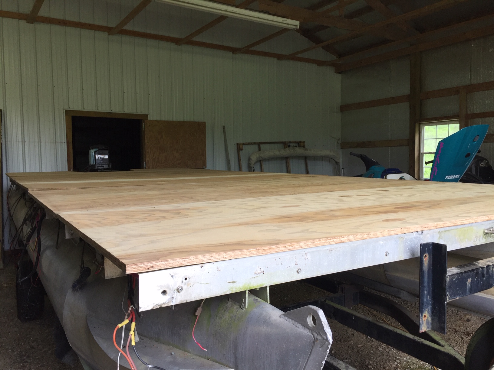

- IMG_2586.JPG (575.15 KiB) Viewed 21889 times

I bought the plywood at my local lumber yard. Invoice says AB Marine. Does this help? I can check with them to get more info.
Yes that’s regular grade A face on one side, B face on the other (which is typical) marine grade plywood. It has more plies then treated wood and due to that is structurally stronger. It has a nicer finished side (A face) with less knots and uses marine glue. It is not pressure treated. It’ll probably last 25 years nonetheless. Always install it with the nicer side up. (A face)
