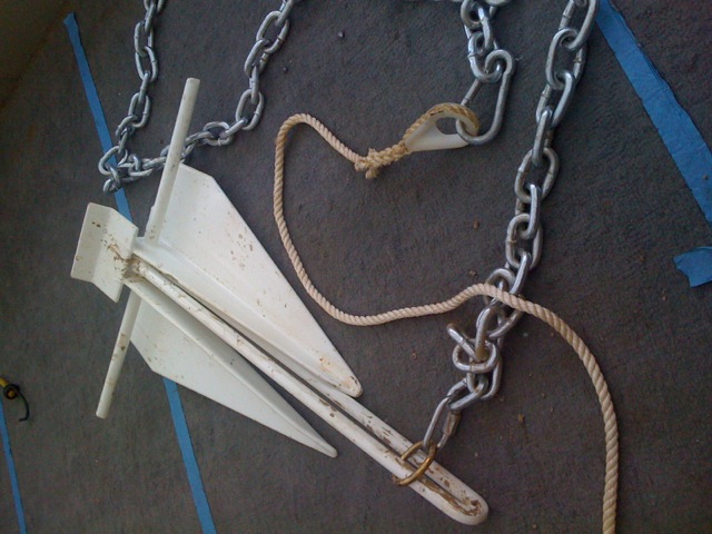

I USE THIS ANCOR OFF THE BACK TIED TO THE RAIL. CHAIN HELPS KEEP THE ANCOR DOWN HELP A BUNCH. YOU NEED ALOT OF LINE THOUGH. AT LEAST DOUBLE THE DEPTH MORE IS BETTER.
USUALY USE A SMALL MUSHROOM ANCHOR OFF THE FRONT TO KEEP IT FROM SWINGING
