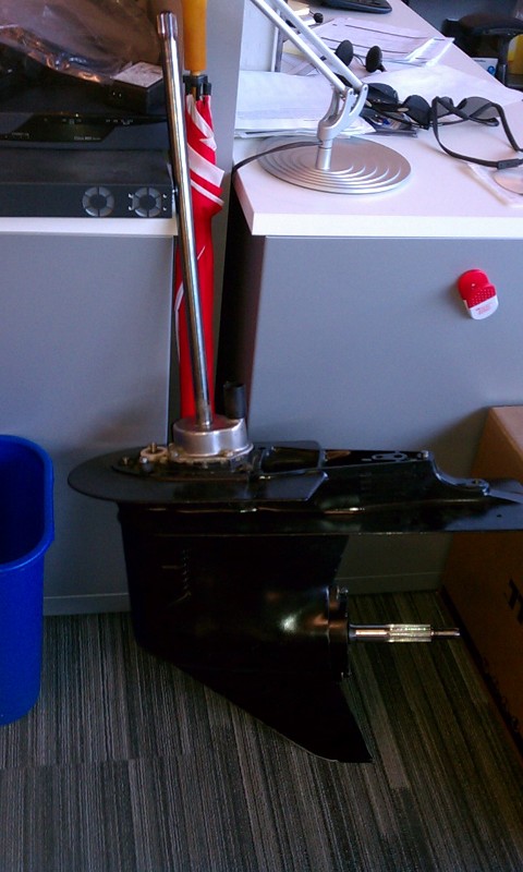

Well boys the lower unit came today. It looks to be in great shape brand new impeller and shifts forward and reverse. Maybe momma gets a cruise on Sunday after all.
530 bucks with shipping.

Looks new. It should be a great deal.

Well we got the lower unit on, it matched up perfectly. Shifts great forward and reverse. However no water pressure!
I couldn't spend a lot of time on it. Do to the funeral. After we got home I realized I may have put the impeller going wrong direction. Most online research said they would flip on their own. Anyone experienced this. The housing wasnt new, on the l-u but the impeller was. When I go back down this is my plan.
1. Shoot water up powerhead to see if clogged. (already checked from pisser to block)
2. Hook up muffs to lower unit unbolted from powerhead, to see if water even reaching pump housing.
3. Put the original housing and impeller that I knew was working on just to see.
4. Sink the fucker
what do you guys think.

Are you talking about overheating on the gauge/beeper going off or just no water from the pee hole?
There is a collar between the output of the water pump to the pipe going up. Did you lose that?
The impeller will fix itself (go the right way) so that is not your problem. Do you have the bottom plate installed correctly in the water pump can? The holes are staggered so it is hard to screw that up but you do need the plate.
One trick is to take out the thermostat and shoot water back through the hole to see if it is coming out of the tube (no dirt daubber nests etc)
Make an adapter out of the end of a swim noodle. You kid won't miss a couple inches.
