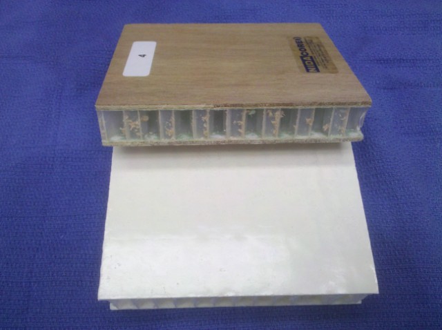

If I was buying a new boat it would definitely have aluminum decking - even for the extra cost since there is a significant weight savings.
When I rebuilt my deck I ended up with 5/8" Meranti 7 ply Marine plywood which does not flex on 16" centers - solid as a rock.
I also strongly considered using a plastic honeycomb composite which once again is a fraction of the weight of plywood:
nida core honeycomb.jpg (57.97 KiB) Viewed 4716 times
playcat
Posts: 1535
Re: deck material?
#9 Post by playcat » Mon Aug 08, 2011 7:52 am
Nice stuff, but out my my league cost-wise. I would love to reduce the weight of my barge but it ain't happening.
