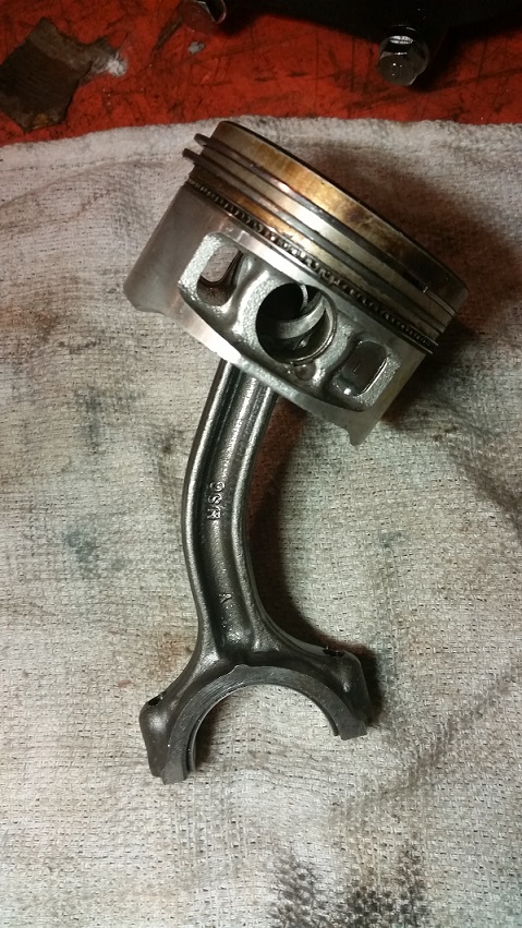

#4 Post by Xscash » Sat Oct 17, 2015 2:02 pm
You may have heard of the "Hemi" motor....well Mercury came out with the "Curve". Must be a new design!
bent rod.jpg (203.71 KiB) Viewed 2031 times

#5 Post by teecro » Sat Oct 17, 2015 4:25 pm
Holy crap talk about a severe case of Hydro-Lock there....

#6 Post by Xscash » Sun Oct 18, 2015 5:28 am
teecro wrote:Holy crap talk about a severe case of Hydro-Lock there....
Yep! This is a 60Hp merc 4 stroke that ingested water at full throttle. No damage to cases or top end. 4 hrs labor and $150 in parts. Great afternoon repair.

#7 Post by teecro » Sun Oct 18, 2015 7:04 am
Wow... It's great that you got off so cheaply on the repair! Did you pick the motor up as a salvage or was it already yours?
