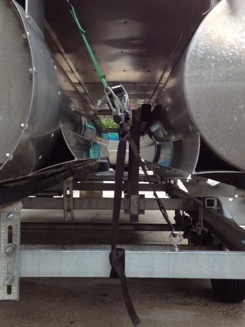

#2 Post by curtiscapk » Mon Mar 28, 2016 6:46 pm

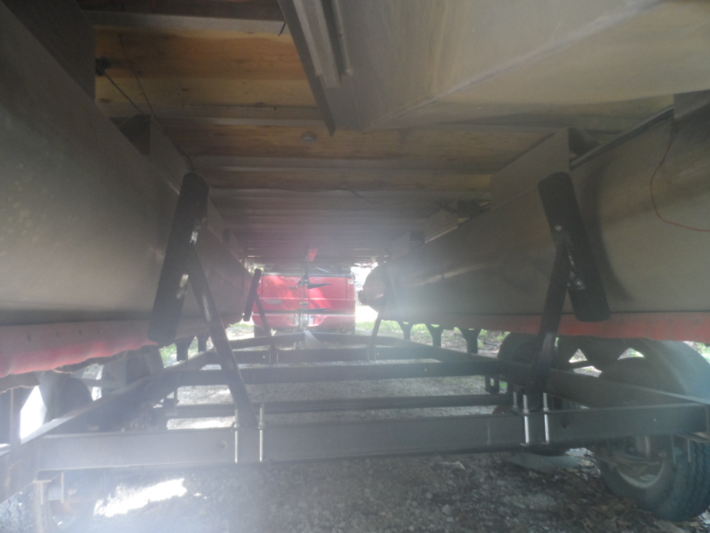

here you go.

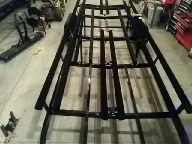

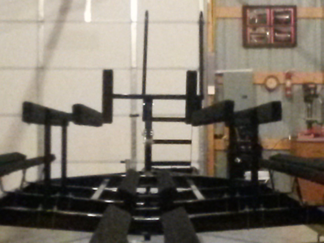

Perfect! I just got done welding up new guides on the trailer for my new Manitou. They will hug the insides of the 2 outer toons and cradle both sides of the center toon. I got the blueprints of the hull from Manitou for the spacing. Can't wait to see the boat on it. Just days away!

Looks good. I adjusted mine so I could slip my hand between the post and the pontoon.

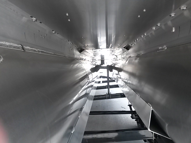

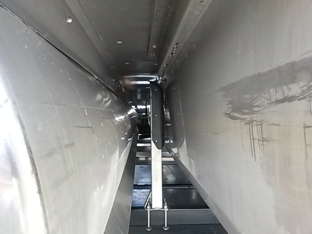

#6 Post by Bryden24shp » Tue Mar 29, 2016 9:27 am

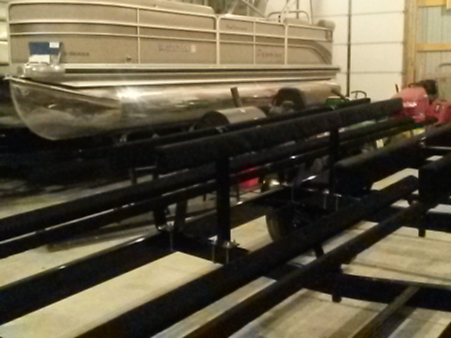

Not to sure about how good these will turn out, but I just snapped pics of the guides I put on the Premiers trailer. These were "rough Water" guides I bought from Overtons, about $120/pair. Work very good. I wanted bunk guides on the new trailer for the Manitou. Last pics you'll see of the Premmie. Her new owner will be picking her up before the weekend.

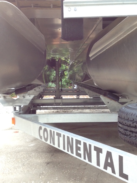

#7 Post by COTTS4x4 » Tue Mar 29, 2016 8:14 pm
Here's mine, I did the bunk style.

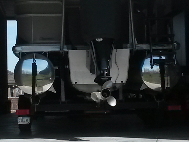

#8 Post by Bryden24shp » Fri Apr 01, 2016 9:24 am

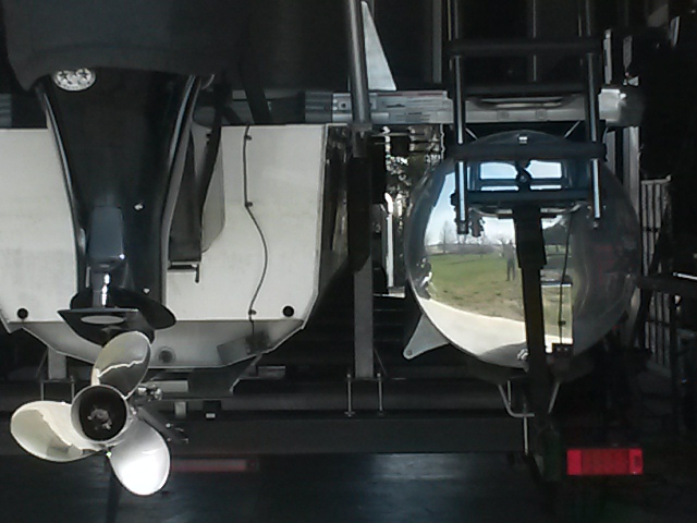

Here is just a quick pic of the new Manitou on the new trailer. I need to adjust the guides a little more when I get the boat home.
