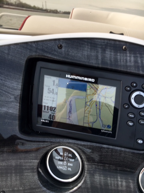

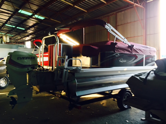

i was wondering which prop i should go with..i think i have it down to 2 props..
2016 Qwest 818 fishtail triple tube..
ETEC 115
26 gallons gas
3 men adults..
full gear..
4 blade 17 pitch 40mph@6100-6200
3 blade 17 pitch 42-43mph@5800-5900
i was wondering if stock RPM gauge could be slightly? According to Evinrude best rpm range is 5800-6000 rpms.. I wanna stick to 4 blade
bc it seem to have more bite in turns and keeps nose down better but don't wanna go over 6000rpm.. I do have ICON gauges(smart gauges) i will be installing but for now only have stock gauge to use..
