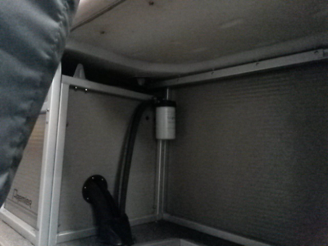

Re: Installing a water separator
Here's a pic of mine on the Premier. I have an open transom, with fuel tank mounted in it. Like Teecro says, no issues at all!
- 20160408_122227.jpg (84.16 KiB) Viewed 7122 times
That's where I wanted to put mine, but was concerned about the 'lift' for the fuel pump. Looks like it's not going to be an issue!!!
Thanks Bryden24shp!!
