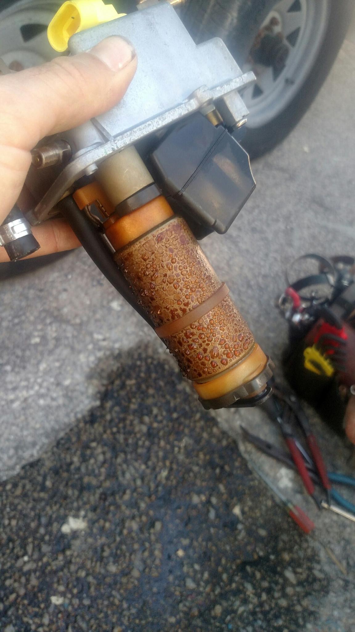

Mercury calls it a Module, other's are referred to as a VST Vapor Separation Tank, Ethanol is a killer, for some reason the mercury fuel pumps inside just get destroyed from the water that collects due to ethanol and long storage. Here is the last one I worked on, you can see the "hose" you are referring to, the black one. This pump was completely seized and had to be replaced. DON NOT Use ethanol fuel..
