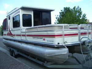

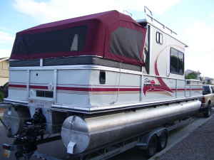

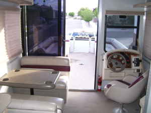

im way out west in albuquerque new mexico
- boat inside.jpg (7.45 KiB) Viewed 6300 times
- boat side.jpg (8.64 KiB) Viewed 6299 times
- boat back side.jpg (8.13 KiB) Viewed 6295 times

Nice ! You'll have a blast with it as we do ours.

nice toon. agee with bmr. if there is a leak it should be listing to one side or the other. if the plugs are on the bottom just pull the plug if they are on the top, use a siphon hose. if by next year it seem like there may be water in there then pressure test somewhere around 4psi. had one in the old toon pressure tested and never did find the leak. guess the small ones are more difficult to detect.

cool thanks for the info the boat is not listing to one side an i believe the boat was stored on the lake in a slip if it was leaking i would guess the water marks would be different on each toon and they are not the water marks are even around the back however the toons do sit lower in the back then they do in the front which i would expect due to the engine and fuel tank
