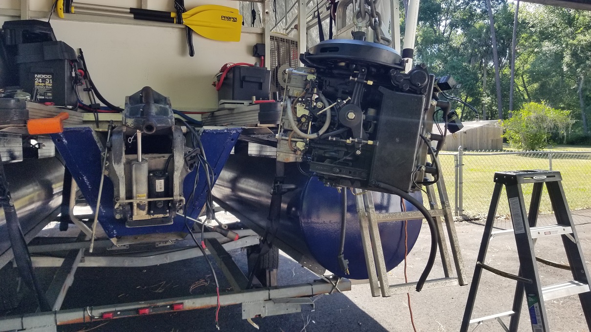

So this weekend I embarked on a journey, a journey i was fairly confident with armed with the service manual. So the bottom of the motor would shake near the bottom of the swivel pin (just above the bottom yoke) so thinking that the bearings had gone bad I ordered new ones in preparation for the upcoming job. The powerhead needed to come off to get to the bearings so I was preparing myself for the job ahead. So I follow the service manual and everything went really smoothly (which is so odd cause it's a boat) and next thing I know I have a powerhead removed:

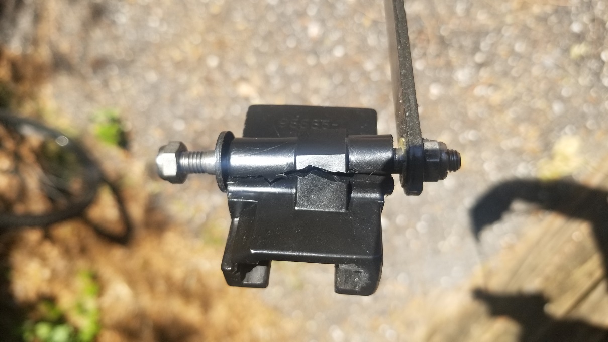

While i was in there I found an issue with the slide bracket for the gear selector:

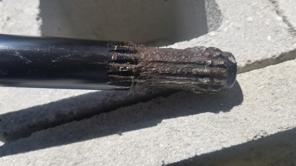

So on to the swivel bracket....remove the locking clamp at the bottom (which I was amazed was still there) and start to notice that the lower yoke seems to be the issue (on no, not prepared for that). get the yoke off and I see this:
spline gone away.jpg (239.21 KiB) Viewed 20813 times
well poop :x
So a quick look online I found a used swivel bracket with all the splines (hahaha) and is getting shipped to me along with the other parts that needed to be replace.
All in all it wasn't a bad job but thank goodness I had the service manual cause that made a world of difference making it easier.
