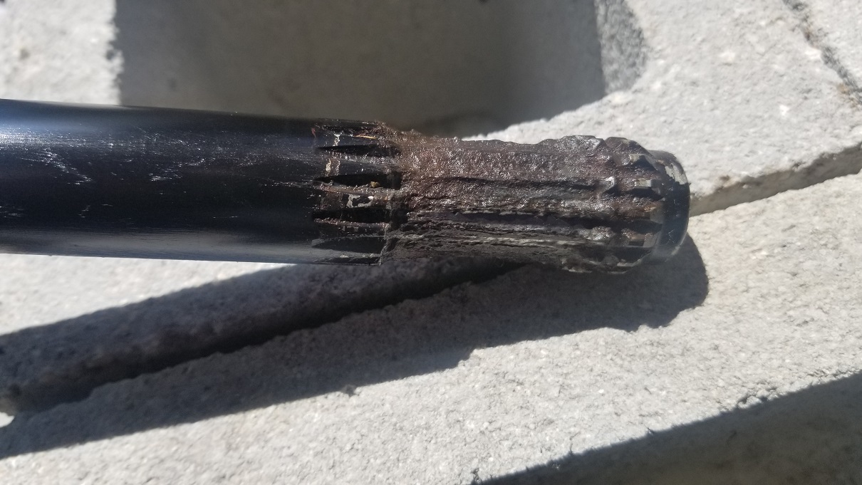

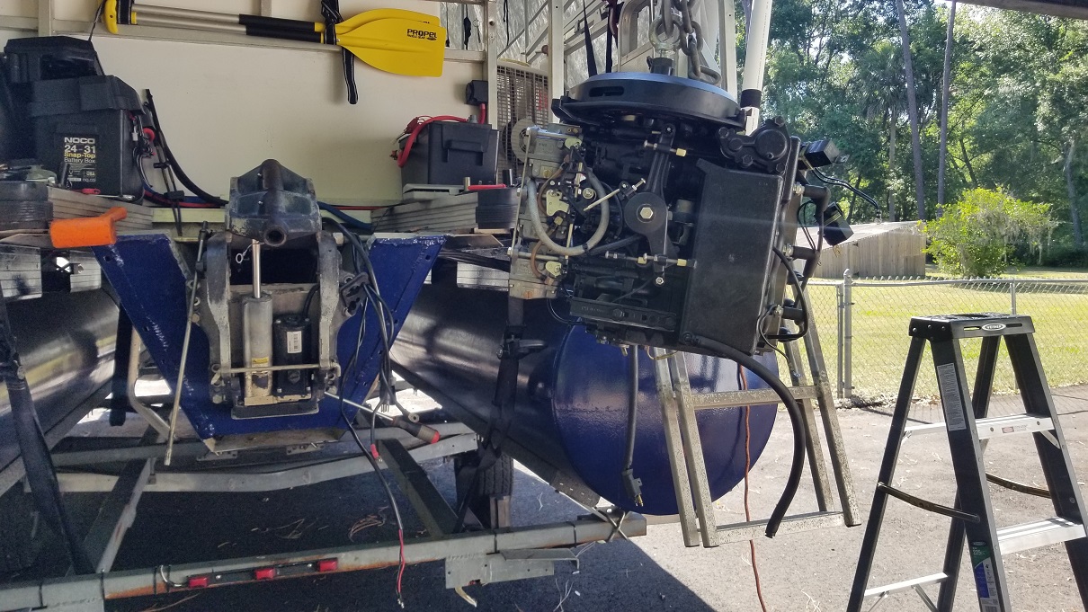

So this weekend I embarked on a journey, a journey i was fairly confident with armed with the service manual. So the bottom of the motor would shake near the bottom of the swivel pin (just above the bottom yoke) so thinking that the bearings had gone bad I ordered new ones in preparation for the upcoming job. The powerhead needed to come off to get to the bearings so I was preparing myself for the job ahead. So I follow the service manual and everything went really smoothly (which is so odd cause it's a boat) and next thing I know I have a powerhead removed:
- powerhead off.jpg (383.33 KiB) Viewed 20823 times

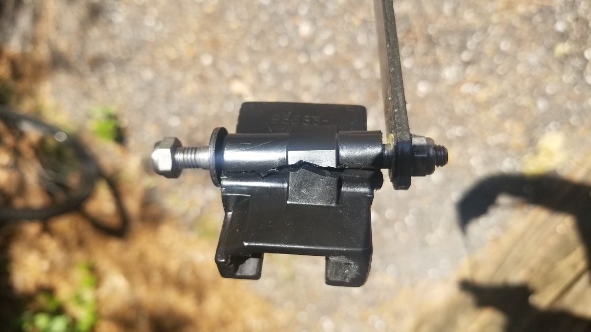

While i was in there I found an issue with the slide bracket for the gear selector:
- broken slider.jpg (186.83 KiB) Viewed 20823 times
So on to the swivel bracket....remove the locking clamp at the bottom (which I was amazed was still there) and start to notice that the lower yoke seems to be the issue (on no, not prepared for that). get the yoke off and I see this:
- spline gone away.jpg (239.21 KiB) Viewed 20823 times
well poop
So a quick look online I found a used swivel bracket with all the splines (hahaha) and is getting shipped to me along with the other parts that needed to be replace.

Technical they are not truly broken...yet.
Looks like good splines outside of the engagement area

got new gasket and impeller put in this weekend on the lower unit, painted the motor cowling and exhaust plate, then found that my trim motor was leaking oil from the reservoir screw(i guess it's a known issue) so I ordered a replacement one and a relief valve screw too since that wasn't in great shape. I'm so close now to getting the motor back on the boat....so close....

the new swivel pin worked great, the motor still shakes back and forth a little because it's not a real smooth idle, but the shaking is way less than what it used to be.
