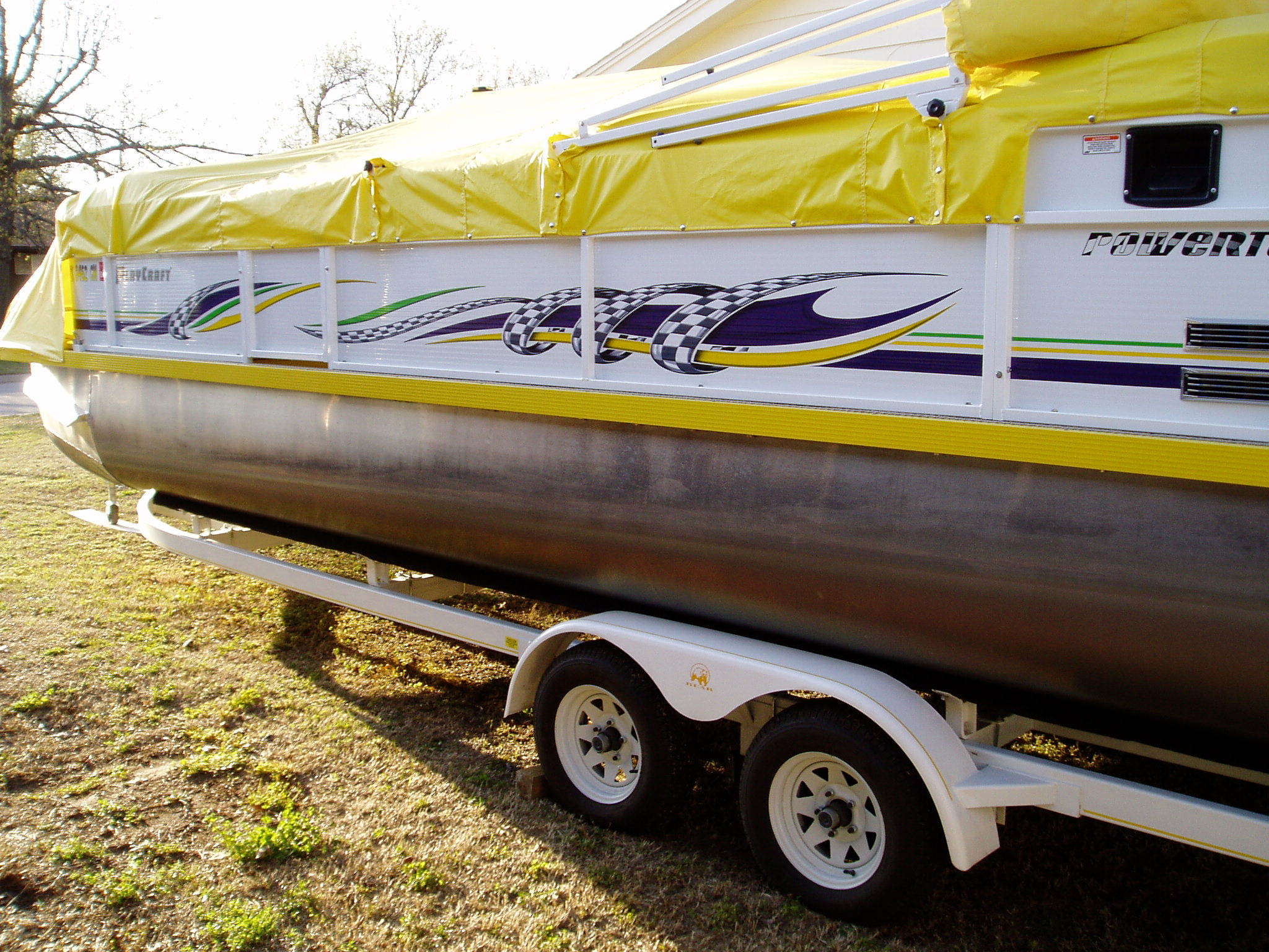

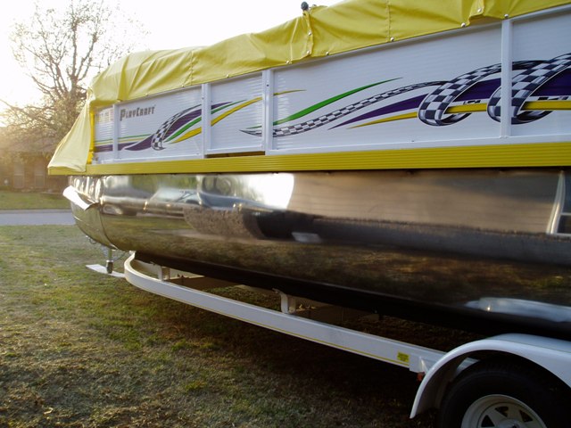

I did mine two years ago and applied Sharkhide after I finished. So far they still look like they did the day I finished. Took two weekends but I'm happy with the results, get lots of compliments. Here are before and after shots.
- P4160017.JPG (74.88 KiB) Viewed 5732 times
- P4130014.JPG (689.05 KiB) Viewed 5734 times

Sorry about the huge pic, my bad.

Re: polishing brand new toons -Void Warranty?
Layne4
thanks for the pics,your boat looks great, this is what Im looking for when I get through. Did you polish the whole toons inside and out and if you did the bottom how did you get to it? I have built street rods and Harleys to drive and show, so part of me just has to reach for the polish, just never done it on such a large scale. So after two years it still looks great , now do you just wipe clean and re apply the shark hide ?maybe get a couple more years , wondering if this can keep going or at some point will you have to strip and repolish starting the cycle over again.
