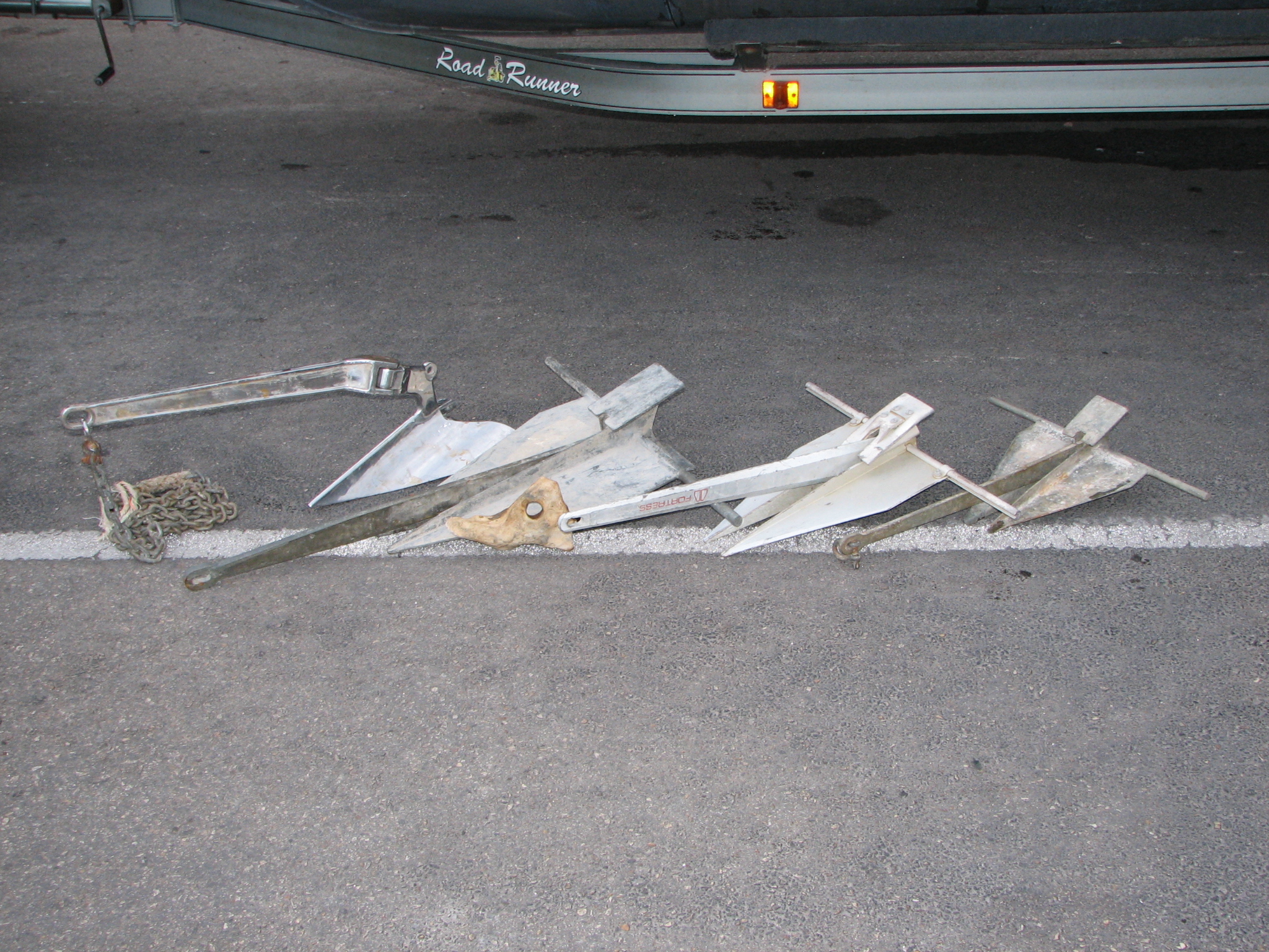

I have a plow now. :nana Found these four on our last dive trip. The one on the left is a 10 kg stainless steel plow. Then a 22lb west marine brand and a fx-11 fortress. And some little one that should have been thrown back. :wink:

Nice find, especially the SS plow. Those things are big $$$$.

Almost too pretty to use.
All cleaned up.

That's why SS is so expensive, it'll outlast you. :tofunny

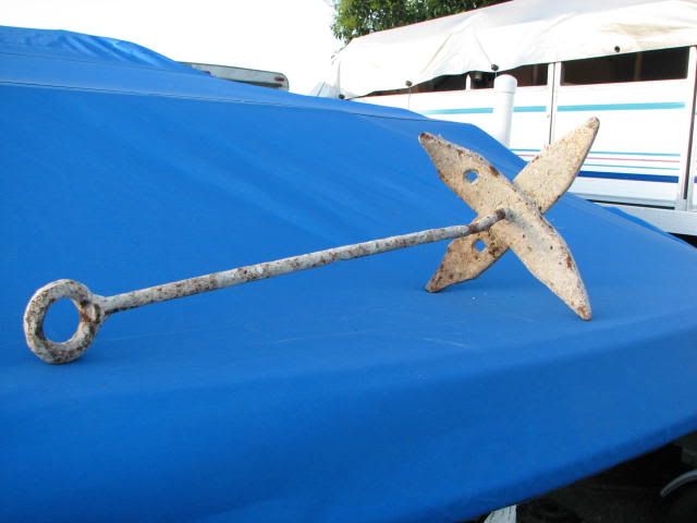

Would you believe the "digginest" anchor I've EVER had is this four (4 lb) pound aluminum home made guy. I took the concept of a "fluke style" anchor, fliped the flukes around where they face outward and gave the head a few more degrees of angle. Then lead with about eight feet of good heavy chain and you're set for the day.
We just spent four days down at lake of the Ozarks and we had as many as six boats tied up with us at a time (and in a pretty stiff wind) and never as much as budged an inch. I also use a good "shock cord" too which helps hold.
