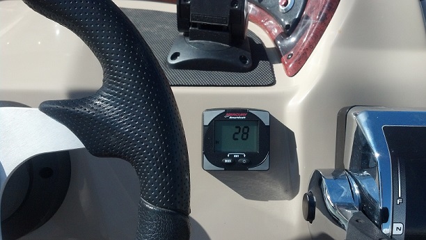

On another note, I also had them install the Merc Smartcraft System Monitor, so I can keep an eye on all engine systems and watch the hours for service interval.

How much did the Merc Smartcraft System Monitor system cost if you don't mind me asking,
looks like a nice system.

The Smartcraft gauge, wiring harness and install cost me around $500.00. It may seem a little expensive, but what's it worth to you to protect a $9,000+ engine/$25,000+ boat?
I probably could have bought and installed it myself for half that, but don't have the time and the boat was already at the shop. I'd rather they do it anyway just to deflect any later warranty claim denials.
This monitors and displays:
RPM
Engine Hours
Oil temp
Oil Pressure
Engine water temp
Engine water pressure
Sea water temp
Fuel pressure
Fuel used
Fuel flow (GPH)
Fuel level
Fuel range (if calibrated to your tank)
Battery voltage
Vessel speed
Trim position
Plus warnings/alarms for:
Engine overheat
Low oil level
Low oil pressure
Low water pressure
Water in the fuel
Engine overspeed
Engine malfunction (fault codes)
Alan

does installation of the smartcraft gauge disable your existing gauges or do they remain functional
Thanks

Existing gauges remain functional. The gauge wiring harness has a separate plug directly into the computer ECM.

After getting fooled by the "simulator" feature on this gauge I didn't get to use it too much before returning to work last time off ship but I thought that I recalled the gauge reading for water pressure. But when I checked again last time home I noted that this is not reading. Have good water pressure out the pee hole... Also I can't get the Trim/Tilt reading to work, I can program it but on display it does not work. Wondering if this is because I have a trim/till gauge in dash already?

BoatCop wrote:... This monitors and displays:
RPM yes
Engine Hours yes
Oil temp yes
Oil Pressure yes
Engine water temp no
Engine water pressure no
Sea water temp no
Fuel pressure no
Fuel used yes
Fuel flow (GPH) yes
Fuel level not using
Fuel range (if calibrated to your tank) not using
Battery voltage yes
Vessel speed not using
Trim position having issue with
I would do a master re-set on the gauge and re-program it. I was having some issues with mine also, and a reset and programming, going step by step in the book, made everything read correctly again.
