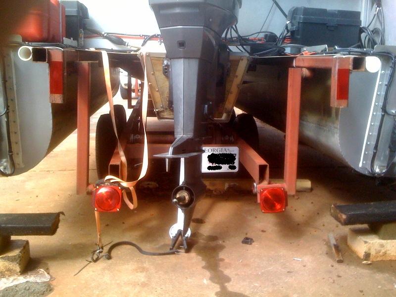

I took my pontoon out for a test run yesterday. I had a few issues.
1) I had a new prop on the motor after rebuilding the lower unit. I think I picked the wrong prop :( . My max RPM was 4500 and I need 5500. I did get 26.6 MPH from my gps unit :thumbsup think I need togo from a 15p to a 13p to get in the torque band :roll: .
2) The back of the toon was sitting very low after adding the weight of the motor and gas tank. :(
3) Water was soaking and splashing and spraying up on the gas tank, batteries, and whole back of the toons.
(do you think raising the motor a bolt hole or two could help with this? :donno ) i have posted a pic of how low the foot hangs below the transom.

I would raise it till lower cavitation plate is even or close to even to the bottom of transom

I would get the motor mounted correctly then work on fine tuning your prop selection.
do like lakerunner says and move the motor up and get the cavitation plate even or close to even with the bottom of the transom.

I don't think you have a motor mount issue. From your photo's it would appear that you have no splash deflector of any kind which many manufacturers put around the transom which would explain the splashing. If you’re happy with your engine's performance, I think going down in pitch is a good idea. Many marine shops will take a prop back as long as it's undamaged and returned in a couple of days so you can get the engine RPM's right were you want’em.
If you go down in pitch expect a small increase in top end (1 or 2 mph) given where you’re RPM's are now and where you want to be. The big performance you'll notice is a better hole shot and acceleration. However, you mention you're increasing diameter which will actually lower RPM's at WOT thus, countering your attempt to get to your 5500. I would try the 14 X 13 but have a 14 X 12 on hand to give it a try.
Gas tank issue, can’t answer to that except that it doesn't make sense that a marine gas tank manufacturer would create a tank that when splashed would allow water in the tank. That having been said, a water fuel separator is always a good idea.
If you raise the motor you will decrease drag (good thing) you'll also lesson prop grip and cause cavitation if raised to high (bad thing). Of course the idea would be to get it at the cusp where you get the least drag with the most grip as possible.

Slingshot apparently likes his mounted lower than the rest of the world. Again, looking at the pics, yours is mounted too low. Swing by any boat place that sells boats or pontoons and ask them the proper height.
you may have a splash shield issue also as slingshot said, but if you don't get the height right, you'll need a splash shield 8 foot high to stop all the water.

I had a 2005 G3 LX20 F/C it had U shaped toons on it also and was a 20 footer. I also had a 90 Yamaha 4 stroke and was propped identical to you. I can tell you without a doubt that your motor is to low. Raise the motor until the cav plate is even with the bottom of the transom. Raise the motor first, the splashing is coming from the motor being to far in the water and its creating drag=splashing. I've been down this road, raise the motor and most of the splashing will quiet down, Rpm's will come up due to decreased drag, speed will also increase. I'll see if I can find a pic of mine.
