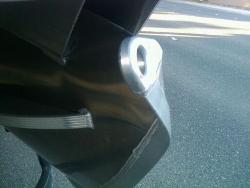

I did the same thing to mine. we heated the area and used a bar to bend it back in place and then finished it up w/a rubber hammer. There was a small hole in the top though that had to be welded (about the size of a felt pen tip).

wijames, I'm glad it got fixed. I'm interested in this because (as you may have read above) my South Bay also has a bent eye on it. Mine looks a lot like sjc195's picture above.
Did yours look like that? Was it bent that much? I might try to fix mine since it worked for you -- after all, I have a rubber mallet! I've always been reluctant to touch it. Like the others expressed above, I am worried it will crack and then I would need a welder. How bad was yours?

woolznaz wrote:wijames, I'm glad it got fixed. I'm interested in this because (as you may have read above) my South Bay also has a bent eye on it. Mine looks a lot like sjc195's picture above.
Mine wasn't quite as bad as scj195's, only bent about 3 inches.

Thanks. I took a closer look at mine. I think I have to leave it alone. It has a bit of "crease" in it and I just cannot imagine that bending back without opening up with a crack. I'll just have to hit the other side to match it! :nono Actually, I think I'll just have to live with it or take it to a welder to fix it, but it would never look like new again.
